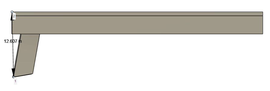

I used the designing software Fusion 360 to just get a visual of what I was going to build. I made it the same size that I was going to in real life. The actual size for corn hole is 12" tall, by 4' wide, and 8' long.

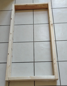

I like to start off this build by building the "base". You can use one of the 2x4x96" boards, and cut it in half for the side lengths. Then, you can take another 2x4x96" board, and cut 2 21" pieces off of it. I took the longer pieces, and put a hole in it, so then it could hold the legs on. I then pre-drilled before I but the deck screws in, so then I had less of a chance of breaking my screws. When putting this together, you want to put the shorter pieces on the inside of the longer pieces.

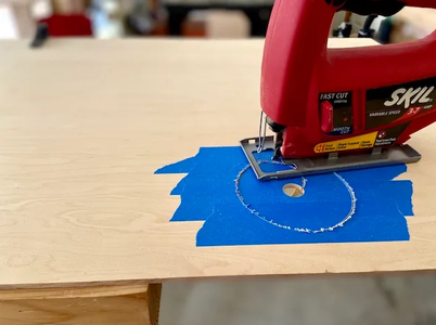

After I finished building the base, I started on the top. I got my piece of ply wood, and cut it down to 2x4'. I the measured 9" down from the top, centered the circle, then cut it with the jigsaw. After I finished that, I put it on the base.

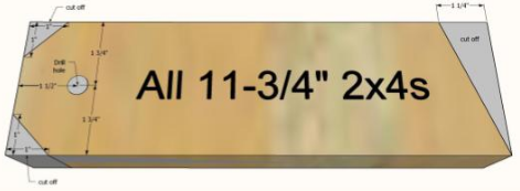

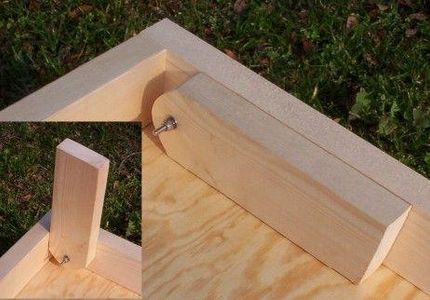

Once I finished putting that on, I made the legs. I took the 2x4", and cut it down to 11 3/4" long. Then I cut the end off, and rounded the top, then put a hole in it.
