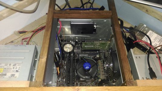

I used the motherboard to mark the case and cut it to length just below the PSU, it was strengthened with a piece of vented side panel which I riveted across the open end, this vented section faces forward and sits flush with the top of the desk.
The case drops into a hole in the desk and sits on two horizontal L brackets which were riveted onto the left and right sides.

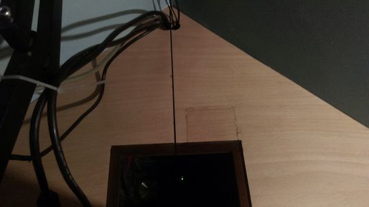

The old top is getting a rework, a new top window needs cut out and the old fan outlet which was put in to cool the 965 processor is not required any more so the hole was filled and both top sections sanded back, the rebate for the glass cut and re varnished.
Front and top sections of glass cut from the old door glass, with a bit left over for another project !!
The filler piece isn't a brilliant match, but close enough and you don't see it as its well behind the screen.

With the 2 old wooden sides removed internally there was no support for the top shelf anymore, the top of the case stops 20mm short of the shelf so I made up a few rails and that support structure sits on top of the case, screwed to the front panel and the back rail.
The psu sits in the corner, and sucks straight down, had to cut a large hole with a holesaw which took ages, the PC ejects hot air to the right, past a SATA drive through the PSU and ejects under the chassis.

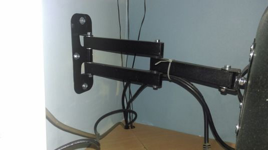

Bolted the new monitor stand to the wall.

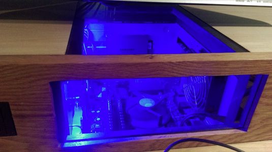

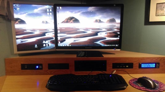

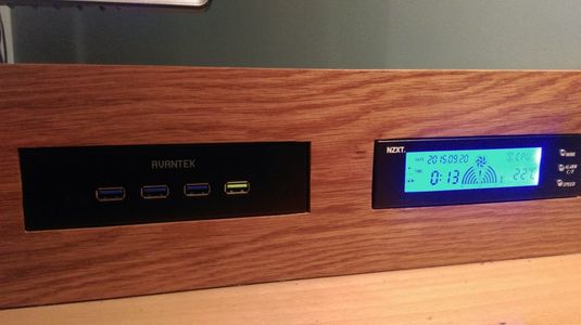

Ripped out the Right hand dvd drive and replaced it with an Avantek USB 3 header with a fast charge socket (green) for my mobile etc, this plugs in to a dedicated socket on the motherboard:
http://www.iavantek.com/index.php?m=content&c=index&a=show&catid=27&id=31
Rewired the light switch and wired in the LED strip from http://www.ebay.co.uk/usr/mkshopuk , was going to use 2 but 1 is plenty gives a nice light without being dazzling.
New SSD mounted to the rear of the chassis, and cabled through the back.
That's about it, its been running fine now for a few months with no issues, loving the silence.

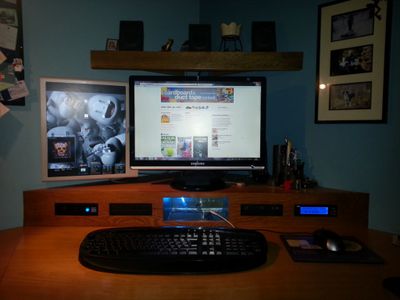

Step 5: Conclusion
Well worth the time and effort, all the boxes have been ticked, its ultra quiet, stock cpu fan and chassis fan that's thermally controlled and seldom on.
Sits at 23deg C quite happily, heat is no longer an issue even when under load.
Top window gives great visibility, should have done that ages ago.
Easily accessible for tinkering now, can work right at the motherboard now without removal and taking the chassis and PSU out is now a 5 min job not half an hour of hitting my head on the bottom of the desk trying to hold the wooden case while unscrewing it.
Hope you enjoy this Corner desk PC update, now at V.3
