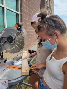

Step 4: Cut the Frame Pieces
Use the Miter Saw to cut 2x 2x4s at 20.75''. Cut 2x 2x4s at 47.75".

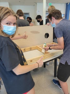

Step 8: Put the Board on the Frame
Apply a thin layer of wood glue across the top of the frame. Line the board up with the frame, and hold it in place with clamps. With the board clamped in place, use a nail gun to secure the board before the glue is dry.
Step 9: Attach the Legs
Get 2 1/4 inch bolts and wing nuts. Drill a 1/4 inch hole 3.25 inches in from the edge and centered vertically. Do that on both sides. Then drill a 1/4 inch hole in the legs centered in the arc. Then put the bolt into the hole on the frame and attach the legs. Make sure the slant of the legs lays flat on the floor when the legs have been folded out.
