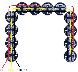

Step 2: Wiring the Neopixels
This is by far the most challenging step. The Neopixels that I had on hand came as individual LEDs that needed to be wired together. If you wish to further simplify the project, I suggest using a strip like this. I can't assure that it would fit properly, but it would require less soldering, and I'm sure that you could get it to work.
What are Neopixels?
Neopixels are a type of RGB LEDs that are controlled through a digital signal, rather then 3 analog RGB values. This means that they can be wired in series, and each LED's state and color can be controlled individually, separate from the other Neopixels. Not only are these useful for creating simple LED strips that can have more complicated animations, but it also simplifies the design by removing the need for a driver circuit.
Soldering Them Together
For this step, set aside 12 of the Neopixel LEDs and a handful of resistors of any value. Set down a piece of cardboard or use a surface that you don't mind hot gluing to. Glue the LEDs face down in a U shape as shown in the picture above. Make sure that the arrows are all pointing in the same direction, going from left to right. This shows the direction the data will flow.
Heat up your soldering iron (I usually set mine to 400C), and one by one tin each contact. Take the resistors, and solder the end to the bottom left, inner corner contact. This contact should be labeled ground (GND). Use the photos and video above as a reference. Solder the resistor to the next ground contact. A single resistor leg should be able to bridge 3 contacts. After the resistor leg can’t bridge more contacts, snip off the remainder of the resistor, and repeat this process using another resistor leg. When you reach a corner, bend the resistor leg, and continue soldering the ground contacts together. Once you solder every ground contact together, we can move on to the data line.
The data line is wired up in a similar fashion, but requires a bit more work because each data pin must ONLY be connected to the next one, and no others. To do this, we start by soldering a resistor to the first DOUT pin on the bottom left. Then, solder this resistor down to the DIN pin on the next LED. Snip the rest of this resistor off. Continue by soldering the DOUT pin on the LED you just soldered to, to the following DIN pin on the next LED. Make sure that no DIN and DOUT pins are connected on the same LED, and that only the following DIN pin is connected to the current DOUT pin. I know it sounds complicated, but reference the video below and the photos above if you're confused. Continue this for all of the data pins, going all the way around the U from left to right, make sure that when you go around the corner that the data line does not touch the ground line.
Finally, the 5v line is wired up exactly the same as the ground line. Starting from the bottom left, use the resistor legs to bridge every 5v line together, being careful to not touch the data line when going around the two curves.
Perfect! The hardest part is done. Lastly, take 3 jumper wires and cut them down to about 2 inches, strip and tin each end. Solder each one to the GND, DIN, and 5V pins on the bottom left on the U. Cover all of your soldering jobs with hot glue, and put extra around the corners to keep the lines from moving and shorting.*
Finally, do it all again for the second lamp
