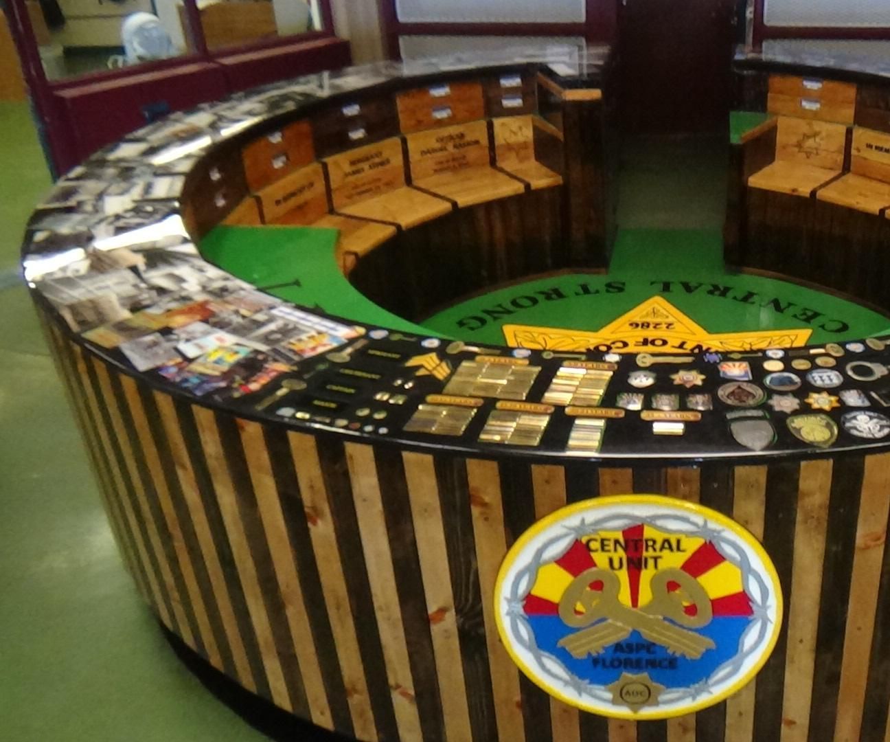

This Flag was made all from wood, it was hand routed with the Correctional Officers Prayer. It is painted with the silver line for Corrections. The flag has all 13 strips and all 50 stars and the Arizona Department of Corrections Badge. Every detail on this flag was hand routed and hand painted. The back of the flag also has hand routing. This Flag is on display at C.O.T.A (Correctional Officer Training Academy) in Tucson. The Flag measures approximately 5FT 4inches long and is 3 feet high. The project took approximately 2 weeks to complete.
