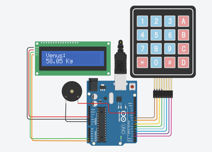

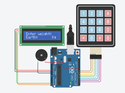

Step 2:
Step 2: Circuit Assembly
Connecting the Keypad
  1. Connect the rows and columns of the 4x4 keypad to the Arduino's digital pins.
  2. Make sure to define the correct pin connections in the code.
Connecting the I2C LCD
  1. Connect the I2C LCD to the Arduino’s SDA(A5) and SCL(A4) pins of arduino, VCC to 5V and GND to GND respectively.
  2. Ensure the I2C address matches the one in your code (usually 0x27).
Optional: Connecting the Buzzer
  1. Connect the positive lead of the buzzer to a digital pin on the Arduino. (D11) of Arduino.
  2. Connect the negative lead to the ground.
(Refer the image for wire connection)
