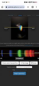

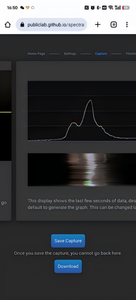

  1. Capture the Spectrum:
  2. Launch the web application and enter the capture mode.
  3. Point the spectrometer's slit directly at your target light source (e.g., a light bulb, flame, or reflected sunlight).
  4. Ensure the light intensity is moderate—neither too bright to cause overexposure nor too dim to be detected—to prevent spectral distortion.
  5. On the spectral analysis web interface, click the "Capture" button to acquire the spectrum image.

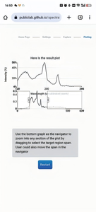

  6. Extract Characteristic Data:
  7. Open the saved spectral image for analysis.
  8. Using the image's calibrated scale or the software's analysis tools, precisely measure and record the wavelengths (or frequencies) of the observed dark lines (absorption spectra) or bright lines (emission spectra).
  9. Accurately note the pixel positions corresponding to these characteristic spectral features, as this data is essential for identifying chemical elements.

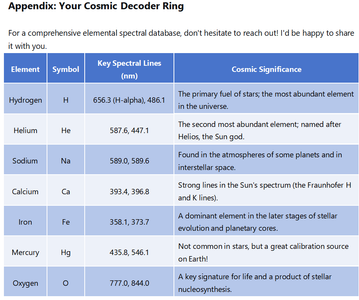

Take your discoveries further. Compare the solar spectrum you captured to published data from observatories. Can you find the lines for Calcium (at 393.4, 396.8nm) or Sodium (the D-line)?
