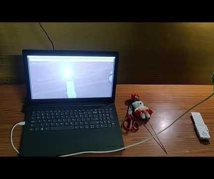

- Thus a thermal Camera has been built with Raspberry Pi and AMG8833.
- The final video has been embedded in this post
- It can be observed that the temperature changes instantaneously as I get the lighter near the setup and the flame of the lighter has been accurately detected by the sensor.
- Hence this project can be further developed for fever detection in people entering a room which will be very helpful in this COVID19 crisis.
