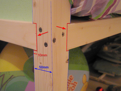

- 850 mm, 2 pcs - lower cross-backs, 930 - 40 - 40 = 850 mm. Rack bars cut into 10 mm from both sides, so not subtract 50 and 40 mm.

Step 3: Make a Notch in the Racks of 10 Mm for Installation of Horizontal Bars.
From the bottom (not milled parts) do cutout 350 to 400 mm. i.e. 50 mm.Cutouts do with those parties where milling. ATTENTION PLEASE! The A-pillars cutouts SLR - Lay details and see which side they do.
