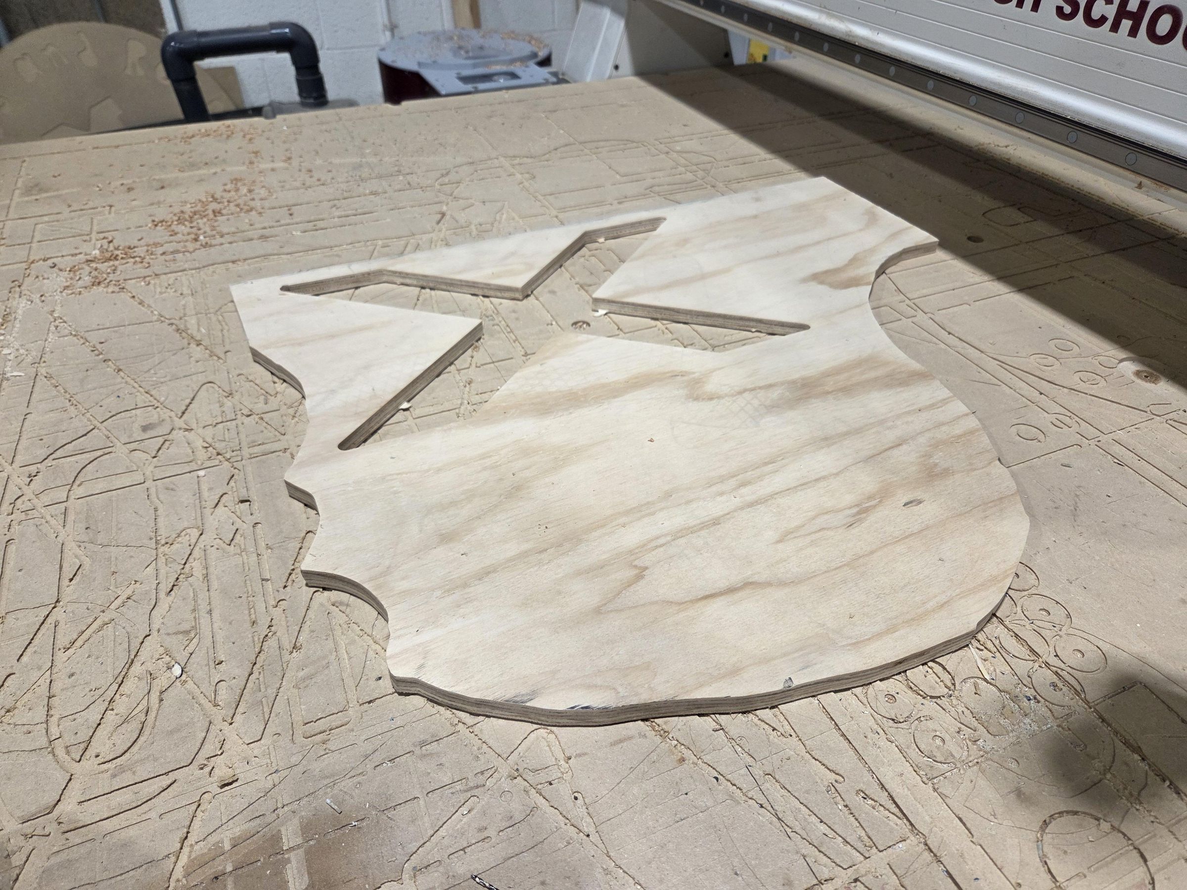

Step 4: Cut Out on CNC Router
With one failed run on the CNC router, I figured out that it is optimal to program the router to cut out inside objects, and then outside objects, as well as drilling holes as the first step. these ensure that if there an issue, the rest of the parts aren't ruined. I found that these feeds and speeds are optimal for the plywood and 1/4" flat end mill I was using.
