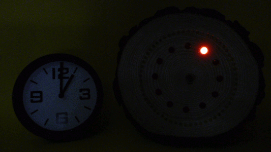

The time lapse video presented above shows CountClock Hours Only Prototype (at the right side) in operation, next to a normal analog clock (left). It is clear that the CountClock only provides an approximate time, which is some cases may be precise enough, certainly for younger children. The clock has been programmed to add the next hour LED when the the full hour begins (for example two LEDs are on between 2:00:00 and 2:59:59).
Alternatively, an "average time" could be opted for (for example three LEDs are on between 2:30:00 and 3:29:59) but that doesn't add precision and therefore hasn't been foreseen in the Arduino programme code. Explained in words when two LEDs are on: the current design shows in that case that "it is after two o'clock" (and before three o'clock). The alternative average time mode would in that case mean that it is "around two o'clock" (two o'clock plus or minus half an hour).
The next step shows CountClock Hours Only Prototype during the night.
Step 2: CountClock Prototype at Night
The functioning during the night is similar to the day mode, with the only difference that at night the LEDs preferably are dimmed. The time lapse video presented (pictured is the CountClock Hours & Minutes Prototype, but the sight is similar for the Hours Only variant) above the CountClock during night (at the right side, a normal analog clock at the left). The cumulative aspect of the clock is a key necessity during the night; would only the hour LED be highlighted (i.e. the fourth LED at four o'clock) it is very difficult to discern its relative position on the dial when there is no further light in the room.
