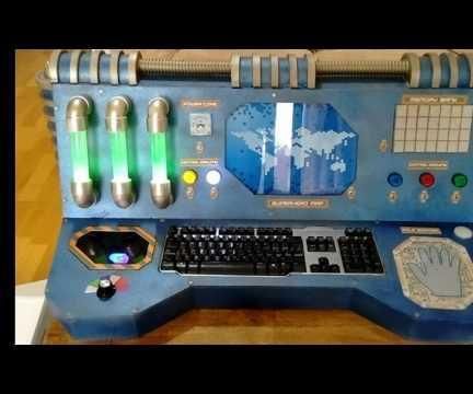

Step 8: The Final Result
Once the countdown timer was ready I incorporated it into a "Launch console" with a few extra switches and lights for the kids to play with.
