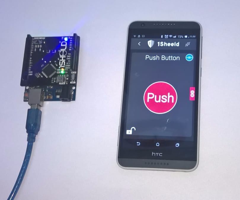

Introduction: Countdown Timer Using GLCD Shield
In this project i draw a countdown timer on 1sheeld GLCD shield ,the user of this project can Determines the duration of the timer using drawn button on the GLCD, when the timer reach 0 there will buzzer sound and vibration.

Step 7: Step 7: Connect 1Sheeld to Your Smartphone Using 1Sheeld Application
You will be required to enter the pairing code (the default pairing code is 1234) and connect to 1Sheeld via Bluetooth.
Step 8: Step 8: Access Shields
  • GLCD shield
  • buzzer shield
  • vibration shield
Press on the multiple shields icon at the top right of the app.
push the reset button of the Arduino to start drawing.
