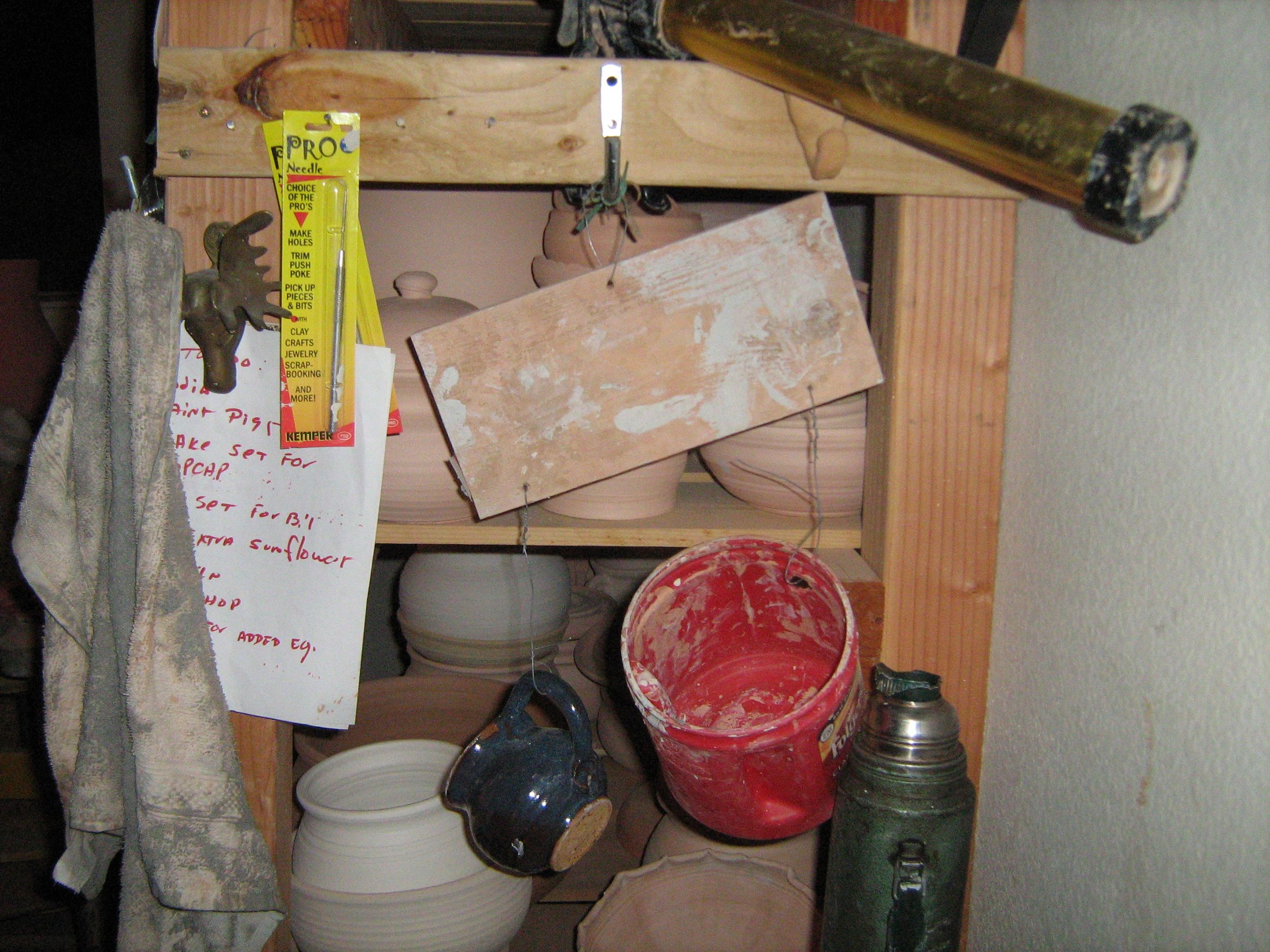

Step 1:
this version uses stock boards, whith no cutting. In my version, I ripped one of the boards length wise on my table saw, to make 2 furring strips, but you can just use one of you dont have power tools.
screw the boards together about 9.5 inches apart. the pint bottles I use are 8 inches tall. screw one of the boards to the back and run a screw through the back at every shelf as support.
