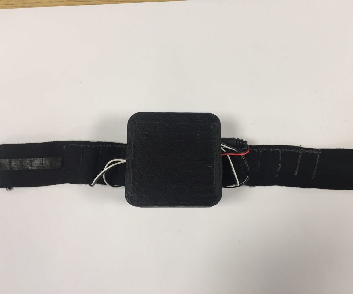

Step 2: 3D Print
I tried two different 3D printed forms for covering the motor: one cylindrical and one rectangular. In my case, I wanted attach them to an armband as simple and flexible as possible. Therefore, there are, for example, sewing holes in the rectangular model. In the end, I decided to use the cylindrical form, as it felt more comfortable on the skin. Nevertheless, you both forms are available here:
