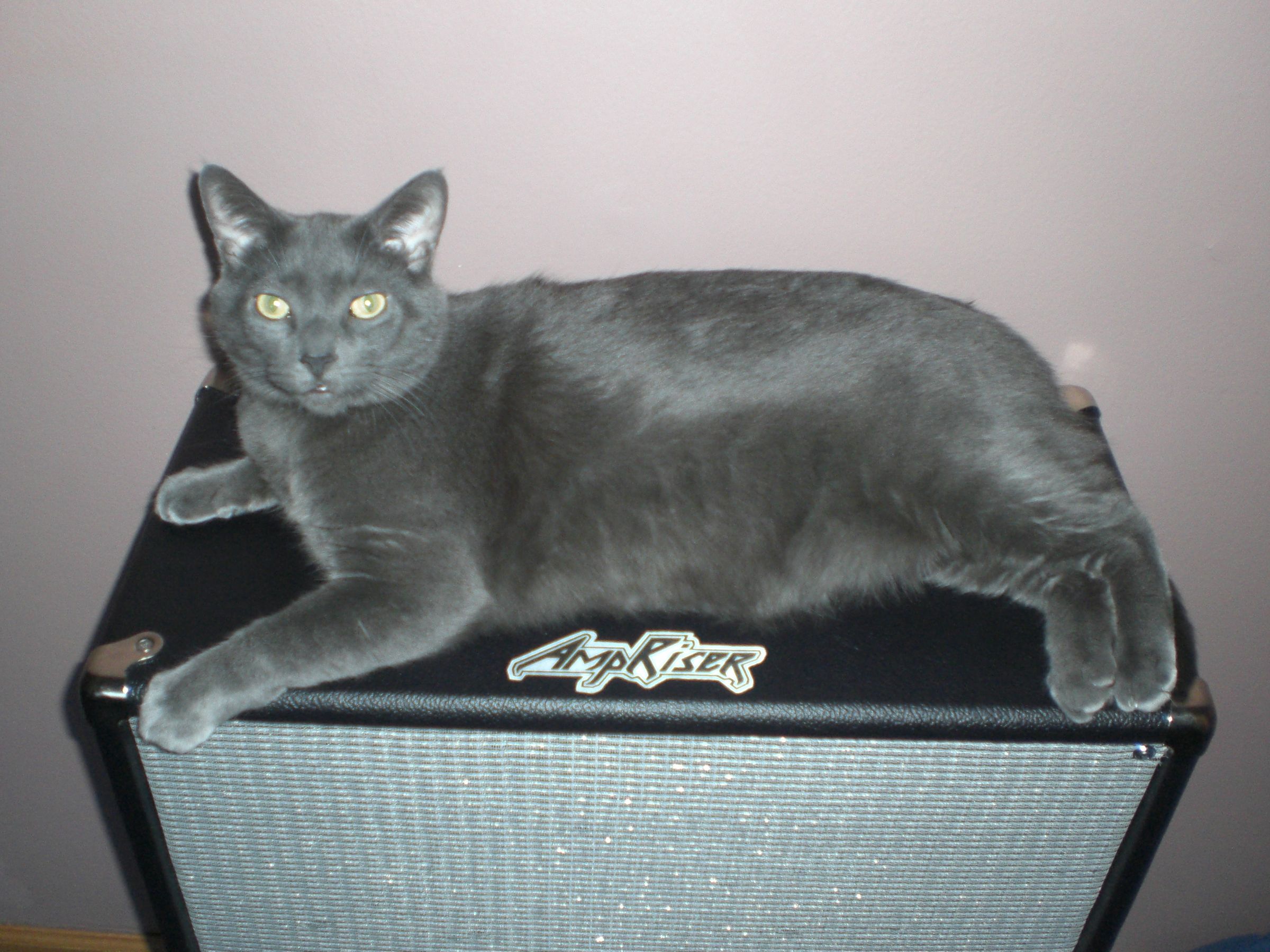

Step 18: Final Touches
After the cabinet is completly wrapped and covered
make all relief cuts and tuck Tolex into the cabinet
