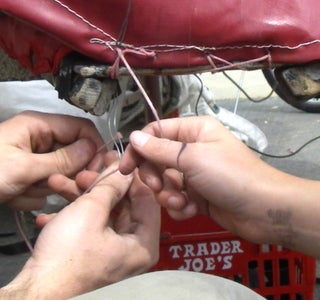

Step 11: Lacing the Skin to the Bows
The skin gets tied directlly to the headboards at the stems. Ray and Chloe use a piece of doubled-over wire to pull the lacing string through holes poked in the skin and drilled in the front edge of the headboard.
Step 12: Lace the Skin Onto the Frame
The innertube lashings that held the frame together were starting to fall apart. We redid a few using polyester string. That's the bright lime green lashings. Then Ray and Chloe laced the skin on with thicker polyester cord. They poked lacing holes, small vertical slits in the hem. The lacing string went around the reinforcing cord in the hem, and around the main inside stringer as seen here.
