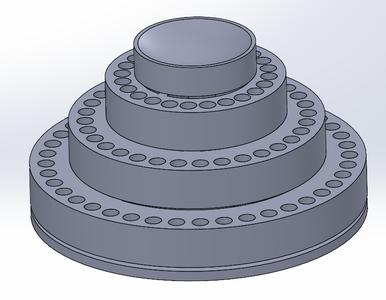

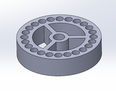

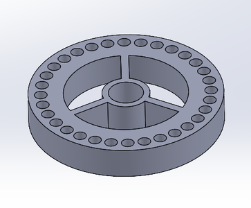

I wanted the crayons to be easy to grab even if some become shorter than others, but realized putting lots of space between adjacent crayons would cause the diameter of the rings to be much too large. For this reason each ring is about 2 inches smaller in diameter than the one below it. This gives enough space between the rings for one's fingers to easily grab the crayon from the front and back. I wanted three rings in total, otherwise it might have been too tall, so I played around a bit with how many crayons to put in each layer so that the geometry would work out for exactly 96 crayons. The combination I ended up with was 40, 32, 24 for tiers one, two, and three respectively. I wanted to make sure that the holes for the crayons were large enough so that the crayons would slide in and out with little to no resistance as well as just long enough to keep the crayon from falling out so that even short or broken crayons would be accessible. Because the diameter of an average Crayola crayon is about 0.3 inches and the length about 3.5, I made the holes 0.4 inches in diameter and 0.9 inches deep, with the rings being 1 inch thick each.

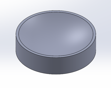

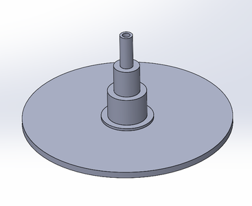

I have seen other people 3D print models in one go that have separate movable parts but I have not designed something like that before so I wanted to design this model in such a way where each piece would be printed separately and then assembled later. I wanted to make sure that the rings would not fit too tightly on the stand so I gave them a bit of clearance so that they would move freely. In order for the rings to be retained I decided there would need to be some sort of cap that would be glued on the top of the stand. I decided to make it a small bowl so that it could hole a few small things like the crayon sharpener from the box or broken bits of crayons that may still get used.

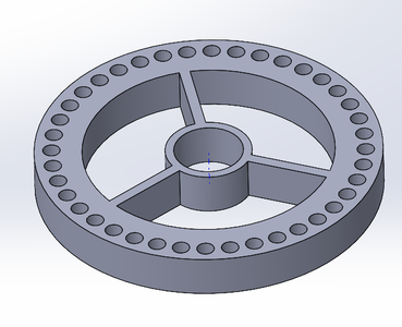

Because this is a fairly large print I was worried about the amount of material it would use. For this reason I designed the rings with the 3 spoke design you see in the images. I made sure that the solid portion of each ring overlapped with the next ring because I did not want any large gaps which would allow crayons or other objects to fall inside of the crayon holder where they would be hard to retrieve or inhibit the rotation of the rings. I also hollowed out the stand to use less material as well. More hollowing could have been done elsewhere but I expected that this would be printed with relatively low infill and so most of the material is in the walls and more hollowing would have just created more walls and the need for supports.

I printed the parts for this model at 20% infill density, but with 3 layer walls to try and save material without compromising strength too much. The only part where it may be wise to print at a higher infill is the stand because the base of it is fairly thin and the top most cylinder could possibly break off if hit or pulled wrong. With these settings the total material usage was a little over 500g of filament and the total print time was a littler over 3 days.

Place each ring onto the stand (DO NOT GLUE THE RINGS THEY ARE MEANT TO ROTATE FREELY).
Add a bit of glue to the top of the stand as shown as well as some to the wall of the pocket on the bottom of the bowl.
Place the bowl on top of the stand apply some pressure while the glue sets.

The Crayola box of 96 crayons has a crayon sharpener built into the bottom of the box. If you wish to use the sharpener you could simply hold onto the box or as shown here cut it out and store it in the top of the crayon holder.
First, open and unfold the bottom of the crayon box and cut out the sharpener with scissors as shown.
Next, apply some glue as shown and fold the cardboard back together so that the sharpener lines up with the hole. (having two layers of cardboard gives is more rigidity).
Trim the edges with scissors as needed, making sure to leave enough cardboard for you to hold onto while sharpening crayons.
When sharpening crayons it would be best to do so over a trash can or some other container so that the shavings don't make a mess and when finished the sharpener can be stored in the bowl on top of the crayon holder as shown.
