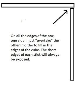

The box has 5 sticks to a side, and has a volleyball-like appearance. This results in a box where all edges of the cube are accounted for, but none of the corners are. On the edges, the short-end side of the cube overtakes the long-edged side.
Almost all of your cuts will be shortening the length. This is why popsicle sticks are so great; there is less cutting and sanding involved, which are the most labor and time intensive parts of making a puzzle box. What would normally take weeks can be done in days.

  •  5W+2T: These form the outer layer of the box. Err on being too long.
  •  5W-2T: These form the second, inner layer of the box. Err on being too short.
