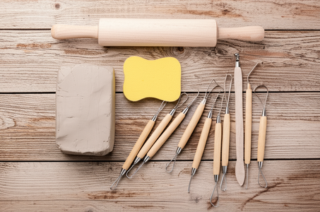

Essential Tools You'll Need
Shaping Instruments:
  1. Wooden modeling sticks for basic shaping
  2. Metal loop tools for carving and refining details
  3. Clay sculpting tools of various sizes
Texturing Tools:
  1. Old toothbrushes for creating texture
  2. Credit cards or plastic scrapers for smooth surfaces
  3. Stamps or rollers for pattern creation
Support and Detail Tools:
  1. Metal wire for cutting clay
  2. Toothpicks for fine details and structural support
  3. Small brushes for smoothing
Workspace Setup:
  1. Clean, flat work surface (canvas or plaster board works well)
  2. Rolling pin for slab construction
  3. Damp cloth or sponge for keeping clay moist
  4. Plastic bags to cover work in progress

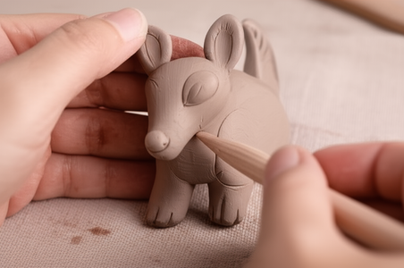

Shaping Process
  1. Build the armature - create the basic body structure first
  2. Add major forms - attach head, limbs, and main body parts
  3. Refine proportions - step back frequently to check overall balance
  4. Add secondary details - clothing, hair, facial features
  5. Create surface textures - use tools to add final details

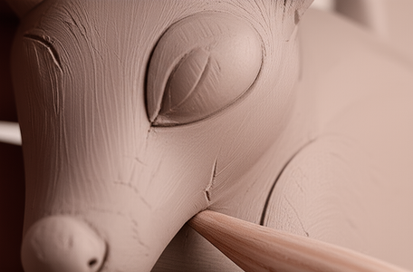

Step 5: Add Details and Refine Features
Detailing Techniques
  1. Facial features: Use small tools to carve eyes, nose, mouth
  2. Clothing textures: Press fabric or tools into clay for realistic textures
  3. Hair details: Use combs, brushes, or carving tools
  4. Surface refinement: Smooth with damp sponges or soft brushes
Critical Considerations
  1. Wall thickness: Keep walls even (about ¼ inch thick) to prevent cracking
  2. Hollow larger pieces: Remove clay from inside thick sections
  3. Support delicate areas: Use temporary supports for thin or protruding elements

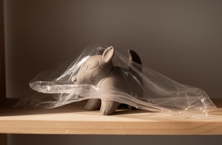

Step 6: Control the Drying Process
Proper Drying Technique
  1. Slow, even drying - cover with plastic and gradually expose to air
  2. Rotate regularly to ensure even moisture loss
  3. Support thin areas with soft materials to prevent warping
  4. Check for cracks and repair with slip (liquid clay) if needed
Drying Timeline
  1. Small figurines: 1-3 days
  2. Larger pieces: 1-2 weeks
  3. Clay should be "leather hard" before final detailing
  4. Completely dry before firing (no cool spots when touched)

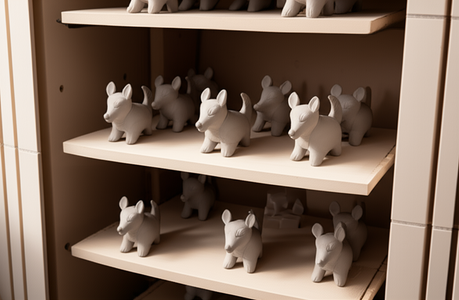

Step 7: First Firing (Bisque Firing)
Preparation for Firing
  1. Ensure complete dryness - any remaining moisture will cause cracking
  2. Check for air bubbles - remove any discovered bubbles
  3. Support delicate features with kiln props if necessary
  4. Load kiln carefully - avoid touching pieces together
Bisque Firing Process
  1. Temperature range: 1800°F to 1900°F (982°C to 1038°C)
  2. Firing schedule: Gradual temperature increase over 8-12 hours
  3. Cooling period: Allow 12-24 hours for complete cooling
  4. Result: Hard, porous ceramic ready for glazing

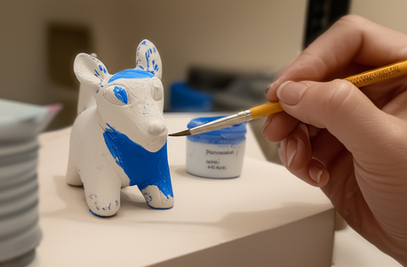

Step 8: Painting and Glazing
Underglaze Application
  1. Clean bisque ware - remove any dust or debris
  2. Apply underglaze colors with brushes in thin, even coats
  3. Allow to dry completely between coats
  4. Build up colors gradually for desired intensity
Glazing Process
  1. Choose appropriate glaze - clear for color protection, colored for effects
  2. Apply evenly using brushing, dipping, or spraying techniques
  3. Clean glaze from kiln contact points to prevent sticking
  4. Check coverage - ensure no bare spots that could cause issues
