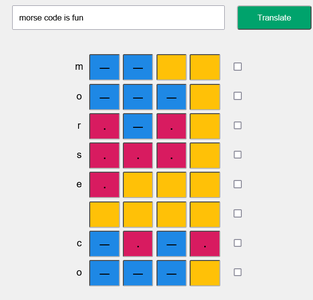

(Optional) Utilize the Morse Code Translator.
  • Choose your desired colors and type your word(s) into the Morse code translator.
  • The pattern displayed is what your keychain will look like.

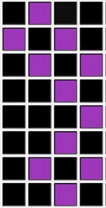

(Optional) Learn morse code through drawing. Students may choose to illustrate their keychain using the “paint mode” on the Morse Code Keychain Assistant.
  • Pick the color you would like to draw with.
  • Input the dimensions of your canvas (units of height, units of width).
  • Click on the blocks you would like to change to a different color.
To learn morse code, students may then translate their design row by row into morse. If a line does not translate, then the student may adjust their design until it is able to be read in morse. For example, you could translate the above designs:
Black: - (dash) or blank
Purple: . (dot)

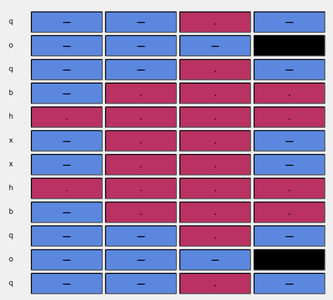

  • To make a crab, paste “qoqbhxxhbqoq” into the translator. Pick two colors, setting dots and blanks for the background color and dashes for the main color.

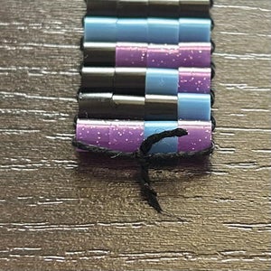

  • Lay out the thread connected to the keyring in front of you, and split the threads into a left string and a right string.
  • Lay out your first row in front of you based on the morse code translator.
  • Left to right will be initially represented as up to down.
  • Take the leftmost bead and put it on the left string, moving it away from the end by about 3 inches.
  • Repeat this process for all 4 beads, the last bead should be about 2 inches away from the end.
  • Thread the right string through all 4 beads in the opposite direction of the other string.
  • Pull both threads in opposite directions to move the beads up to the keyring.
  • The beads will naturally want to curve around the keyring but you will want to make sure they are straight.
