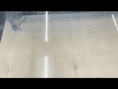

In my quest to craft a precise Nerdy Gurdy, I turned to the CNC laser cutter available at my local maker space for a number of compelling reasons. Firstly, it simplified the process, significantly saving time and effort. Secondly, it offered a level of precision that would have been challenging to achieve using traditional hand tools.
The plywood I initially used had a slight bend due to storage. To rectify this, I applied weights to straighten the plywood, ensuring that the parts were perfectly flat and ready for laser cutting. This correction enabled the CNC laser cutter to precisely cut the parts to their required dimensions. The remaining minor bends were subsequently addressed during the gluing process, resulting in flawlessly crafted components for our Nerdy Gurdy project.
It's important to note that while the CNC laser cutter was my chosen path, you can absolutely craft these components using ordinary hand tools if you prefer or do not have access to such machinery.

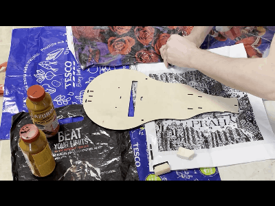

Step 3: Staining the Body
I chose the sunburst staining effect for our Nerdy Gurdy's body because I've always been drawn to the beautiful patterns found on guitars. The sunburst effect, with its gradual color transition, adds a special touch to an instrument.
To create the mentioned sunburst staining effect on my Nerdy Gurdy's body, I began an intricate process of dying. This technique involved blending green and black ethanol-based wood dyes to achieve a visually striking transition of colors. First, I prepared the wooden surface by sanding it smooth, ensuring that the dye would adhere evenly.
The process began with a base coat of green wood dye, applied uniformly across the gurdy's body. This base served as a vibrant backdrop for the transition to darker hues. The heart of the sunburst effect lay in the delicate feathering of black wood dye from the outer edges of the body toward the center. Achieving a smooth and gradual transition demanded precision and patience, requiring a steady hand to create the iconic sunburst gradient. The outcome matched my vision perfectly, and I eagerly anticipated seeing the final product.

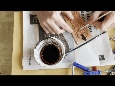

The journey didn't end there. After the keyholes were satisfactorily prepared, I decided to dye the keys themselves. I began by dying them in the same color as the body sunburn, so that would enhance their visual appeal. However, this step posed a unique challenge. Dying the keys caused them to undergo slight dimensional changes due to the absorption of the dye. Consequently, I had to spend additional time sanding the dyed keys to restore their original dimensions.
To make the keybox truly stand out, I chose to embellish the lid with a layer of 4mm leather. Before gluing the leather, I took the time to stamp intricate patterns of oak leaves and acorns onto it and applied the same colored dyes to bring those patterns to life. The result was a keybox lid that serves its functional purpose, but also looks stunning and complements the overall feeling of the instrument.
