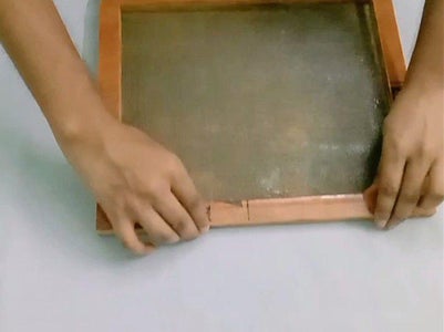

First I cut four 1"x11" plywood and four 1"x13" plywood. then placed one 1"x11" plywood at one end of the 13"x1" plywood perpendicularly so that 1" of the 13" plywood gets overlapped, marked the points on each of the plywood through which it will be joined and drill a hole through the points , then hammered a 2" nail through those holes. similarly I joined two another 11" and 13" plywood cutout. Then joined the two 13"-11" plywood assemblage so that the inner frame has 10" breadth and 12" length. the mould is done.(Refer image 1,2,3,4,5,6,7)
similarly I made another frame of the same dimension as the mould.((Refer image 8 )
Then I started attaching the 13"x11" fiberglass mesh from one side using a gun stapler. and like that the deckle is done.( use the stapler properly so that the tension of the mesh is even through out the frame.)(Refer image 9,10)

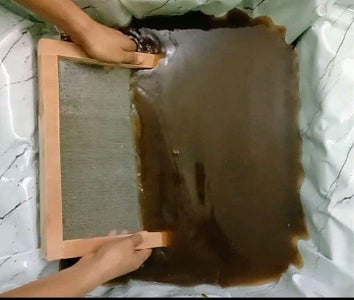

First I prepared the vat and poured a lot of water into it, then poured the slurry straw pulp and the gooey okra syrup into it. And mixed it thoroughly using a wooden pole.( I poured 8 part water with 1 part pulp and 1 part formation aid)(Refer image )(In the image I used thick pvc sheet elevated by wooden frame as a vat cause my vat got damaged, so use a proper plastic vat which is easily available in store.)
Then holding the mould on top of the deckle I put it into the mixture and gently shaking the hand I brought out the mould-deckle from the mixture, there by producing a thin layer of pulp on the screen. Then I held the mould-deckle for few seconds so the excess water leaves.(By moving the the mould-deckle slightly try to create a layer of even thickness, and the more inside the mixture you put the deckle the thiker the layer of pulp becomes)
Now I slowly removed the mould from the deckle. And gently placed the deckle on a cotton sheet so that the thin layer of pulp sets on the sheet. Now I used a sponge to further soak the water out of the pulp. Lastly removed the deckle gently, there by producing a screen of pulp on the sheet.( soak as much water as you can using the sponge, the more water is out the faster it dries)

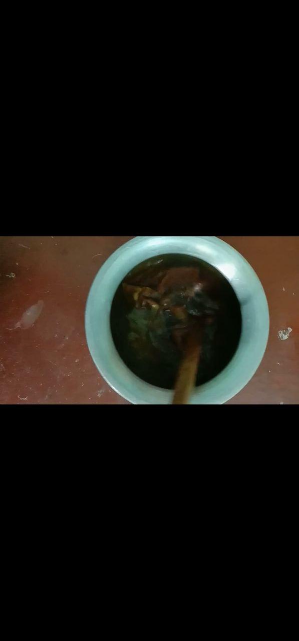

Now to prepare the darker shade I boiled 1L of water with 5tbs of grinded coffee and left it to cool down a bit.
Then I gently folded the wax drawn cloth and submerged it into the warm coffee mixture. I left it submerged in it for 6 hours , occasionally stirring the cloth for an even shade.
After soaking it for 6 hours I pulled out the cloth and gently wringed out the excess dye.(The more time you leave it for the darker the shade will be, and also while wringing ,the wax cracks here and there through which the dark shade goes into, creating a unique batik pattern.)
