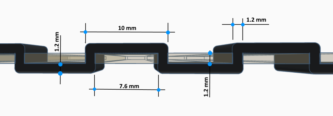

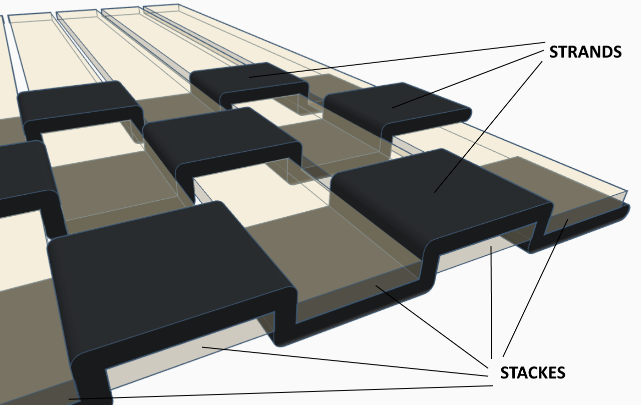

The type of basket weaving technique on which my proposed method is based is often referred to as "Stake and Strand." It utilizes some rigid strips or threads of the raw material called 'stake,' around which thinner and more flexible threads or strips of the same raw material called 'strand' are woven. Of course, I cannot rely on the flexibility of PLA, which is quite brittle by nature. So, I will print the strands already "bent," as can be seen in the drawing below.
The resulting "channels" will accommodate the stacks, which won't pose any issues; they will print easily since they are straight.
According to my rather approximate calculations, the thickness of the strand should be around 1.2mm to provide sufficient strength, resulting in a final coaster thickness of 3.6mm. It's visually pleasing, thin, and delicate, in my opinion. However, there's nothing stopping us from increasing this thickness or slightly reducing the size of the channels for the stacks, thus decreasing their size (in cross-section). With a material strand thickness of 2.4mm, we would achieve a coaster of 7.2mm, quite sturdy and resilient. I don't believe increasing the thickness further would be necessary, as it might result in rather bulky and aesthetically unpleasing coasters. For the purposes of this article, I have worked with strand and stake materials of 1.2mm "thickness."
