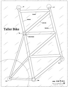

  4. Blueprints
  5. 1:1 scale blueprints based on height, allowing you to choose the appropriate frame size.

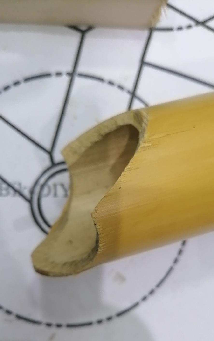

miter cut and sand the bamboo tubes at an angle to ensure they fit snugly with the aluminum connectors like the bottom bracket, head tube, and dropouts. It's recommended to start with the seat tube, followed by the down tube, top tube, chainstays, and seatstays.
If you have professional tools for angled cuts, the process will be easier. However, even without specialized equipment, you can still achieve good results—perfect seamless joints are not essential since carbon fiber will be used for reinforcement.
After miter cutting, sand the areas to be joined, including the bamboo joints and aluminum connectors, such as the head tube, seat tube, and dropouts. Remove the smooth bamboo skin and make the surfaces rougher for better adhesion. You can also use a handsaw to cut some grooves into the bamboo for additional grip when wrapping the carbon fiber.
Tip: Naturally grown bamboo is not always perfectly round or straight, so when making miter cuts, skillfully use the curved sections of the bamboo to achieve an aerodynamic effect.
