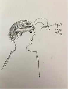

Step 1: Step 1: Sketching and Planning
I started this project with two options, one was a pair of mittens with fade in/fade out led lights for bike riders while the other option was to build a hat with a lamp hovering over it to read at night within a personal space. Then, I decided I could make a better circuit with the hat to make a touch sensitive sensor to turn the lights on and off as well as intensifying or dimming the lights with the ATTiny.
