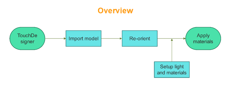

Step 3: 💀Skull Model Setup and Materials in Toucdesigner Part One
🔧 Opening a New Project
  1. Open TouchDesigner.
  2. When you launch a new project, you’ll see a few default nodes already in the network.
  3. Clear the Workspace:
  4. Right-click and drag to select all the existing nodes.
  5. Press Backspace to delete them.
  6. This gives you a clean canvas to begin building your audio-reactive skull setup from scratch.
