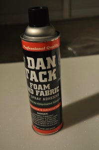

Dan Tack Foam and Fabric Adhesive (apparently the 3M version is good also, but more than 4 times the price, the guy at the foam store recommended this.)
Dan Tack Foam Silicone Spray (this may not be needed, but helped get the foam into the cover and may be good to provide some lubrication between the cover and the foam when there are drops.)

We started by gluing the foam. We were worried about fumes from the adhesive, so we set up in the garage. We laid down some drop cloths and put the foam together and lined it up. We then took one piece off of the sandwiched foam and turned it over. Then I sprayed both sides of the foam and let it sit until it felt dry and tacky (just a few minutes). After each application we cleared the nozzle by turning the can upside down and spraying until only air comes out. Then we carefully guided it back in place and pressed the pieces of foam together. We repeated for all of the pieces of foam. Then we had the thin pieces in the center left. We let it dry for around 30 minutes and then worked on the thin pieces.
Then we propped open the foam to get to the thin pieces in the center. We sprayed the adhesive again and let it dry. During drying I put a stool under the end to ensure that the thin pieces had good contact. We then put the pieces together and made some measurements so that I could start sewing at techshop.
