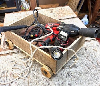

I needed to use more tools than I could carry while crawling on hands and knees back to a water heater under our house in a crawl space. It was a distance of about 65 feet each way. One knee began to bleed a little even though I wore knee pads. To keep trips in and out to a minimum I made a tool cart I can drag behind me. It is about 12 x 15 inches with 3 inch wheels.

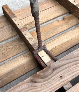

A few years ago there were a number of Instructables about making claw devices for deconstructing a pallet so the wood does not break apart and can be reused on a new project. I made my own version with 1/2 inch concrete rebar and a piece of pipe for a handle. See the second photo. An easy way to prepare the pallet lumber for jointing on a project like this is simply to shoot one edge of the boards with a longer bed plane. The plane in the photo is the wood bed plane I made with a blade for a block plane. The plane is about twelve inches long and it has become my favorite plane. My table saw was piled high with all sorts of things when I wanted to make this tool cart, but not spend a lot of time making my table saw ready.

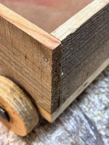

Despite carefully jointing pieces for the box that is the body of the cart, there are slight warps and distortions in the pieces. I used clamps to pull things into shape and hold them in place. But, it is a cart for moving tools under a house, not a piece of furniture. I applied a good wood glue to each joint and used finish nails to hold things in place until the glue could dry.
I did not want to split the pieces I used, so I ground the head from a finish nail and chucked it in a drill. I used the finish nail as a bit so the hole would be an exact fit for a finish nail. I removed the nail used as a bit and drove a nail with a head into the hole. This works rather well. The hole made with the spinning nail in the drill chuck does not drill as deeply as the nail is long, so the nail does grab well, but does not crack the lumber. Leave the clamps in place until glue has dried and cured.

I used a 3 inch holesaw to make the wheels. They automatically have a 1/4 inch centered axle hole. I did allow some old motor oil to soak into the wood around the hole for smooth operation later.
Step 5: Mounting the Wheels
I made axles with mounts. I used a piece of 1/8 x 3/4 inch flat bar welded to a piece of 1/4 inch rod. But, a hex head bolt 1/4 inch in size smooth above the threads to the bolthead would make a good axle. Just drill a 1/4 inch hole into the edge of the 3/4 inch plywood, cut the bolt to length, put a washer, the wheel, and another washer onto the bolt, and drive it into the hole with a hammer. I drilled the flatbar and mounted my axles with two wood or sheetmetal screws each.

Fortunately, our crawl space has enough height to allow being on all fours while crawling, and the dirt floor is not rough. But, my poor knees were suffering from several trips in and out at about 65 feet of crawling each way. This cart was a very big help. It tracked behind me quite well and was easy to pull.
For your information, I was attempting to replace a water heater element. It was very stuck and a normal wrench for such things had no effect. The Internet showed me many use an impact wrench with a 1 1/2 inch impact socket to remove stuck elements. It sounded extreme, but it worked very well. The stuck element released and I did not even hear the hammers in the corded electric impact wrench clatter. A large electric drill probably would have done the job, at least, in this case. A socket for a regular ratchet probably would have worked, too.
