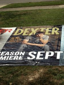

Vapor barrier. What the heck kind of vapor barrier? Definitely not that wussy 6 mil plastic you can get from the nearest home improvement store. What the encapsulation pros use is a thick vinyl material. I'm sure that to buy that material new would be exceedingly expensive and reduce your savings. That's why I got used billboard tarps from Billboardtarps.com (actually I think I bought them through Amazon.com, but they were from these people).
This stuff is tough. They are three ply 15 -17 mil vinyl, tear resistant, mildew resistant, waterproof. They are made to last years outdoors exposed to UV and winds, so just imagine how long it will last in the dark under your house. Hell, people use these for pond liners!
And they have cool stuff printed on one side of them. Check out the pictures.
I estimated that I'd use 2 of the 14' x 48' models. They come in many different sizes.

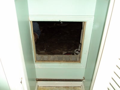

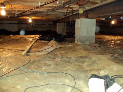

My crawlspace is only accessible from inside the house so it helped to unfold the tarps on the lawn and then refold them to make it easier unrolling them in the crawlspace. Do this to best suit your needs. We folded the 14' side in half and then rolled the tarp up from the 48' end. We then folded this bundle in half making a 7' bundle to carry into the crawlspace. Once inside it was easy to unfold it and roll it out.
If you're up for doing a lot of cutting and going back and forth you can carefully measure your crawlspace, work out a little diagram, and cut it piece by piece.
* Use the drill to make holes in the concrete. Hold up the furring strips and use them as a template for your drilling.
* Apply a bead of silicone along the top of your concrete blocks, this will be a watertight gasket that will keep the humidity rising out of the Earth down under the barrier.
* Arrange the tarps so that once they are screwed in place behind the furring strips they will drape down the wall and onto the ground.
* Spread everything out evenly and cut away excess in as big of pieces as possible. These pieces we ended up using in patching holes where needed.
* You'll want to overlap any cuts by at least 1 foot. In many instances I ended up with 2 feet. You can use HH-66 to seal the joints, but I chose not to. I know that the water line running into the house has been in the ground since the early '60's and that the huge old cast iron drain will need to be replaced so I didn't want to have to cut and patch later. You can use housewrap tape if you wish, but my overlaps were so big that I didn't bother with either.
