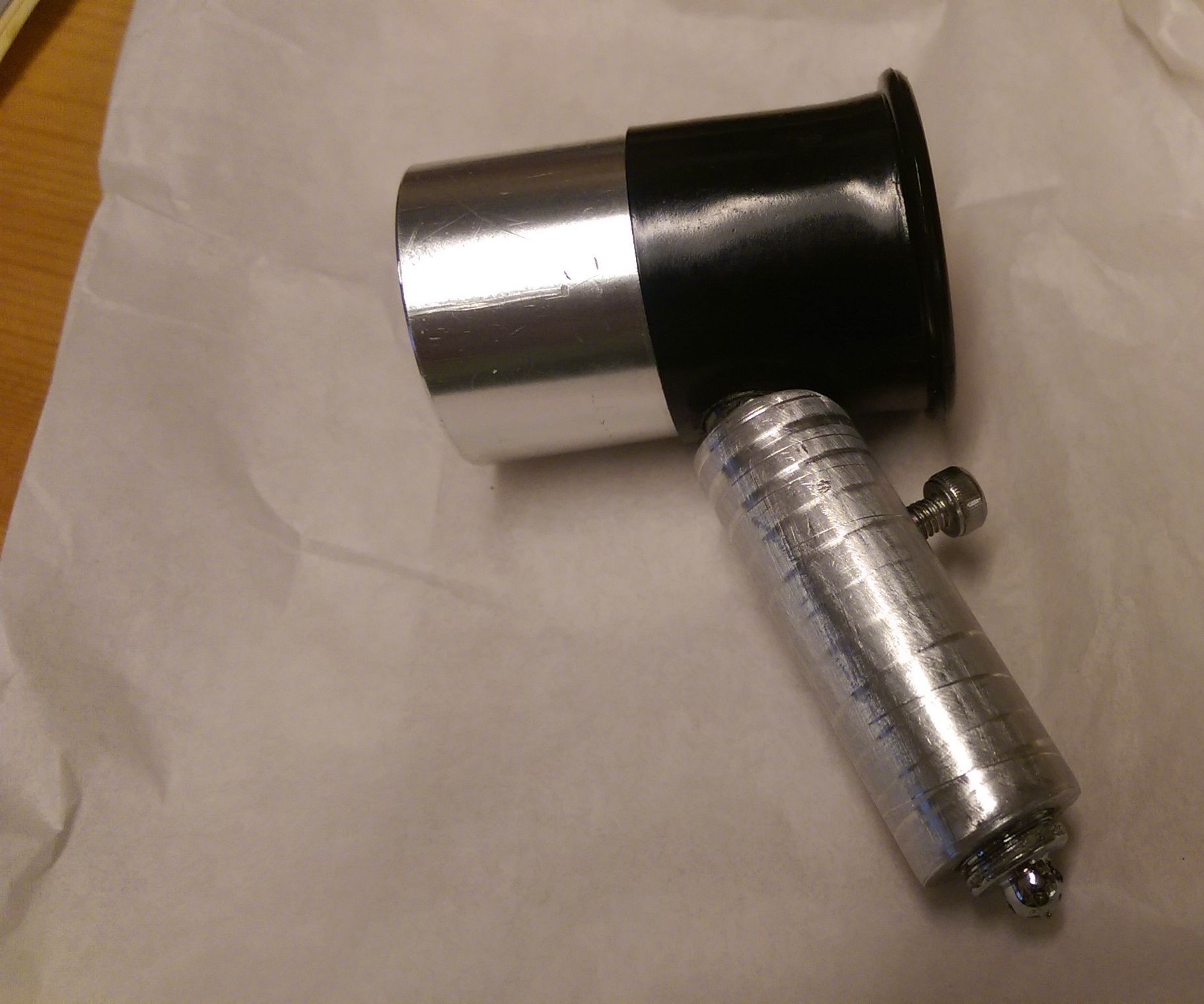

There are many ways to solvethispart of the puzzle (Crazy Brits! This guy just used a spare screwdriver!). What I did was to use a hole saw to cut a disk out of a plate of scrap aluminium. What you get after that is an annular disk of aluminium. You have the centre hole from the hole saw and the rest of the disk. That left me with the problem of attaching the knob with a hole that was about 4mm to the approximately 2mm axle. To solve that one I chucked a short piece of aluminium rod in the drill press and sanded/filed down the rod slowly to get to an estimated friction fit between the hole left by the hole saw. I heated the knob with a propane torch to expand the aluminium and quickly pressed in the rod while the knob was still hot. The second knob worked better than the first. Aluminium likes to glom onto itself (for those not familiar with the term "glom", think an almost magnetic attraction and sticking between the parts). Practice; practice on scrap. Then I drilled and tapped the shaft of my adapter for grub screws.
Step 9: Retaining Screw
Last, you need to mount a retaining screw for the eyepiece. Just an M4 cap screw preferably with knurling on the cap. Look at your eyepieces and see if any have a machined depression for an eyepiece screw lock. Mount the retaining screw so that it will fall in that location.
