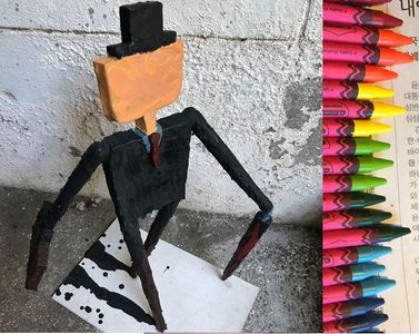

Step 3: Assemble!
Now you need the hammer, nails, and wood glue.
I said, NOW YOU NEED THE - hey, you can take out the earplugs now!
This is a method I've seen a lot of sneaky finishing carpenters use to hide connections.
For each piece, gently hammer in a nail or 2 where there will be connections. I used 2 in the hat, and then 1 each in the arms, legs, and the neck, so 10 in total (I know, but I dropped 3!).
Then grab the angle grinder - oops, you'll need to put the earplugs back in! - and change to a grinding disc. Grind off the nail heads and then grind each stump to a sharp point. VOILA - you've got double-pointed nails!! Now gently, oh so gently tap the pieces together.
WAIT!
Don't forget a drop of wood glue for each connection!
OK, now gently hammer the pieces together. In my case, some of my scrap wood was really soft so I was able to just push the pieces together.
I also used the angle grinder to shape the connection joints to get the angles right. Shoulda told you that earlier, right? Sorry.
In any case, my little figure is now assembled and has a dynamic look about him, like he's taking a jaunty walk through the city. I added the umbrella and briefcase with just glue since the connections were way too small to nail. Hope they stay...!

Step 6: Colour Your World
This step is where all the fun happens!
Choose which colours you will work on first, usually starting from the top to the bottom. If necessary, tape off areas to keep the wax from spilling on them and to protect the wax you're already poured.
Heat up your colour and apply it. I used a spoon to dribble wax on small areas, and I picked up the can and poured it over large areas for a great runny effect.
It's best to work over parchment paper because you can be as messy as you like. I just waited a minute after a pour and scraped up the wax with a knife to put it back in the melting can.
Have a lot of fun here - I used sombre colours but of course you can use whatever you like!
And obviously I don't need to tell you that hot wax is dangerous!
Step 7: Final Assembly
To attach the necktie, I used a lighter to melt the back of it and quickly pressed it into place. E-Z!
Then my wife told me I should mount this guy on a board and who am I to argue? So I prepped a scrap of fibre-cement board and marked out the foot positions. Then I poured wax tracks. I wanted it to look like this guy is melting into his world. I then superglued the feet and umbrella point down and it was DONE!
Not sure the cat is a huge fan, though.
