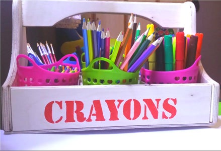

Having a caddy at home to carry and store the crayons is a must! So I have decided to make one to store my nephews crayons. It was a fun and easy build and it took me a couple of hours to make and finish it.

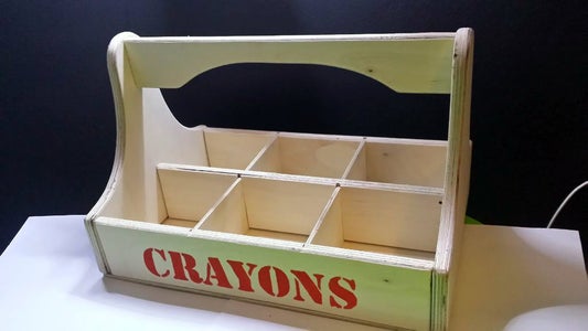

Step 5: Assembling the Tote
Now its time to assemble the tote. You are going to need a brad nail gun or just some regular nails and some wood glue.

Step 8: The Dividers
Cut the dividers out of 4mm thick plywood! Test fit them to see if they fit snugly! You are ready for painting!

Your crayon carrying tote is ready, now you can varnish it or paint it the way you like it, or use a stencil and a spray paint to write on it like I did.
