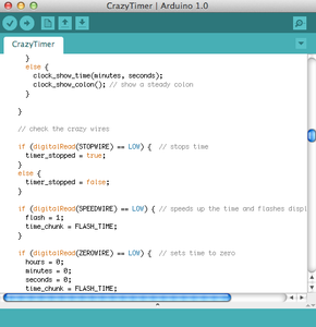

Step 3: Install (upload) the Software
The final step is to download the attached software sketch, and upload it to your Arduino.
That's all there is to it - you now have your very own Crazy Countdown Timer!
You can press the button to set the time. Hold the button down to set it quickly. If you hold it for longer than 5 seconds, it will go 10 times as fast.
The centre hour:minute colon blinks for the seconds when there is more than an hour left on the countdown timer, otherwise it displays minutes:seconds and the colon remains steady.
The software has some comments to help you figure it out, but essentially it keeps track of time by checking the value of millis(), and every time 1000 millis have gone by it counts down by 1 second. Millis() returns the number of milliseconds since startup.
When in panic mode, it counts down 10 times as fast - decrementing the second indicator every 10th of a second.
As with my earlier Arduino Clock Instructable, this won't be as accurate as using a real time clock (RTC), but it's good enough for our countdown timer.
When the timer hits zero, the action right now is to turn on the LED that is already connected to D13 (you can see it light up in the video when I disconnect the red wire). Since the pin will provide 5 volts, you can actually also use it to do other actions, like turning on/off a relay or even running a little sound gadget from an old greeting card, for example. You could also modify the code to do more interesting things - for example, you could connect a speaker or buzzer and use the Arduino Pitches library to make a noise (see the Arduino's built-in Digital-Tone_Melody example).
Enjoy!
