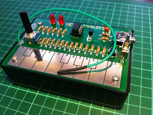

These instructions will give you all the info you need to build a crazy looper, Schematic, software file etc. I got the circuit board made but you can easily use vero board because it's such a simple circuit.

Step 2: Resistors and Wire Link
*Solder the 4 1K(R5 R7 R8 R10) and the 2 10K(R2 R4) resistors to the PCB.
*Solder in the wire link at S2.
Step 3: IC Socket
Solder the 8pin IC socket to the PCB
Step 4: Audio Connector
Solder the 3.5mm audio connector to the PCB.
Step 5: Capacitors
Solder the capacitors(C5 C6) to the PCB.
Step 6: LDR
Solder the LDR to the PCB. Make the LDR sit about 8-10mm from the PCB.
Step 7: LEDs
Solder the LEDs(LED1 LED2) to the PCB.
Step 8: Voltage Regulator
Solder the voltage regulator(IC3) to the PCB.
Step 9: Variable Resistors
Fit the 10k variable resistors VR1 and VR2 to the PCB.
Step 10: 9 Volt Battery Clip
Solder the 9 Volt battery clip to the PCB.
*(optional) At this stage you can add some hot glue to the spot where the leads attach to PCB to stop the wires from breaking.
Step 11:
Fit the two knobs to the variable resistors.
