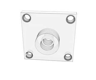

My filament holder is on top of the enclosure and passes through the enclosure via 2 pneumatic couplers with a pieces of PTFE tube in between (See photo). Ive included the STL for the pneumatic coupler holders.
Ive used E profile rubber draft excluding strip on the door, and toggle latch clamps that create a near air tight seal.
Im aiming to make mine air tight, using a 3d printed wiring panel comprised of gx16 female connectors, ill update this instructable when that is completed.
