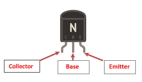

Step 1: BC547 TRANSISTOR(BJT) PINOUT
Here is the BC547 Transistor pinout configurations.

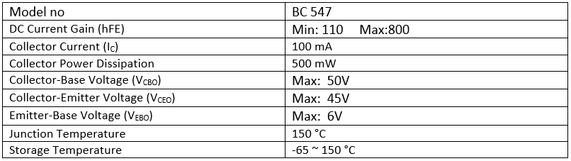

Step 2: BJT Datasheet
Know your BJT - BC547 Transistor before starting to create the circuit.

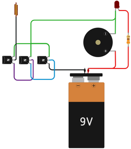

BJT stands for Bipolar Junction Transistor. It has three terminals Collector, Base and Emitter. This project is based on the concept of the Darlington pair circuit. A small signal is provided at the Base of the 1st BJT with the help of the Antenna. Corresponding to it BETA times larger current flows from Collector to Emitter. This concept is used in Darlington pair with the help of multiple BJT, 3 BJT in our case. Now from the circuit, we can see that the Emitter of 1st BJT is connected to the base of 2nd BJT and then the same is happening with the 3rd BJT. This is the main concept behind the working of a Contactless AC voltage detector circuit. Output is taken from the Collector-Emitter terminal of the 3rd BJT which is connected to the Buzzer and LED with help of a 330ohm resistor.

Step 5: Circuit Diagram
In the above circuit diagram, there are 3 BJT whose collector terminals are connected to the LED and buzzer. Positive supply is provided at the positive terminal of the buzzer and LED whereas negative is supplied to the emitter terminal of the 3rd BJT. The resistor will limit the current flow into the LED. For the antenna, you can also take the winding wire and make it in the form of a coil structure which will act as an antenna to receive the magneticfield from the wire which is having phase supply.

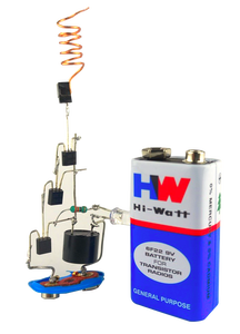

Step 6: Contactless AC Voltage Detection Circuit
The final Contactless AC Voltage Detection Circuit will look like this.
