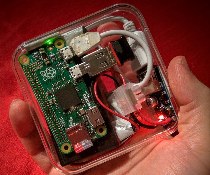

Seeing the potential of Google Assistant as it was presented in Google I/O 18 as well as Volvo Cars in their infotainment system, I could not resist trying it out. I reused one of my older projects, VasttraPi and interfaced it with Google Assistant. If you want to read more about the project, I would be delighted if you take a look at the related article on my blog: Custom actions for Google Assistant.
In this Instructable we are going over the steps necessary in order to launch your own Google Assistant Action which will communicate with your server and talk back to you, listing upcoming departures. Keep in mind we are not going to use the SDK since we are running this completely within Google Assistant and not our own device. Overall it is going to be kept simple. Your action will be usable on devices that support Google Assistant such as phones, tablets, home assistants and wearables and you can even share it as you would with an app on the Play Store!
