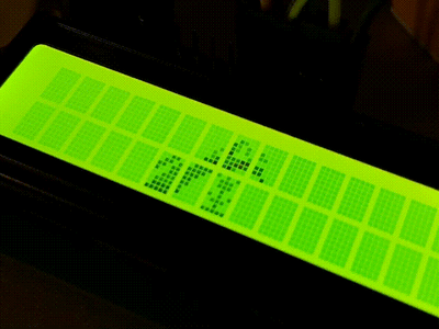

Go to the tool at https://tusindfryd.github.io/screenduino/ and create your art. Up to 8 sections can be used at once, so if you cannot select a new square, make sure you're not using 8 sections already.
Step 3: Generating the Code
When you're done with your first image, uncheck the box "just the function". Copy the code to clipboard and upload it onto your Arduino. At this point you should see your image on the LCD - pretty neat, right?
Step 4: Making More Frames
Make sure your code is saved. You can now create the second frame. Just draw another image. When you're done, check the box "just the function". Copy the function and paste it at the end of your code. Rename the new function to something else - like image01(), so that you can keep track. Now you will need to move the call to image() from the setup() function to the loop() function, add a delay, call image01(), and add a delay again. Consider renaming image() to image00() for consistence. Your loop() function should look something like this:

Step 5: Here's an Example Animation: a Butterfly Metamorphosis
