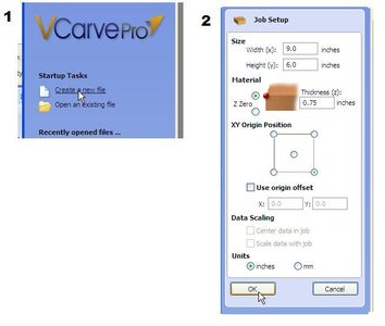

TechShop has for you to freely use, one of the easiest and coolest software: VCarve Pro.
So, Open it and click to "Create a new file" (1) and insert the dimensions of the piece of wood you want to carve (2), in my case,9"x6", set the thickness (0.75"), the upper corner as Z Zero, the lower right corner as XY Zero, and leave the rest untouched. Click OK

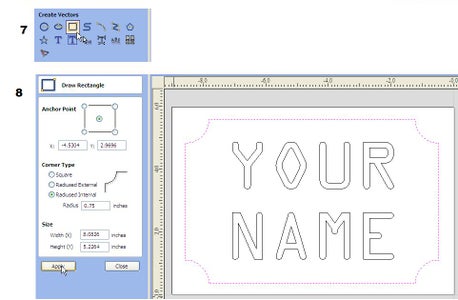

Click on "Draw rectangle" in the "Create Vectors" menu (7), select the Corner Type you want (i selected "Radiused internal", for a fancy finish), draw the rectangle on your design and click "Apply" and then "Close" (8).
Left click on the rectangle and center on material as in the previous step.
Now you should see your text and the border neatly aligned with the material.
Make any adjustment you need and then save the project before proceeding to the next step.

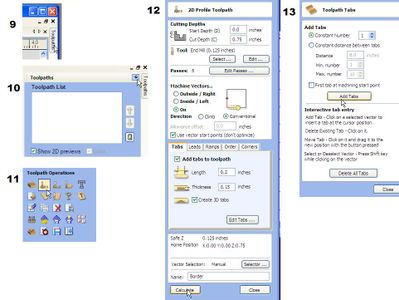

Step 4: Define the Toolpaths
Now it's time to define the Toolpath, the instructions that we will feed to the ShopBot to create your final piece.
On the top right corner, move your mouse over "Toolpaths" (9) and click the little pin to keep the window from sliding back (10).
Select the border you defined earlier and click on "Create Profile Toolpath" (11).
The 2D Profile Toolpath appears (12)
The most critical parameter to define is the "Cut Depth", you want to be exactly the same as your workpiece, so that you do no go over and damage the board underneath (I now, we are just simulating the process here, but better do things right and learn the right steps, you won't be sorry!).
So, measure the thickness of your workpiece and enter it.
Define the machining path as "On", and "Conventional" as the direction.
Since the tool will cut through the material, you need to set "Tabs" that will keep the external shell in place (and, in the real world, will be cut away).

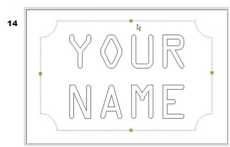

Set the length and thickness, check the "Create 3D tabs" box and click "Edit Tabs": the "Toolpath Tabs" menu appears (13); select "Constant Numer" and deselect the rest. Hit Add Tabs and place 4 tabs on the border as per figure 14. Click Close, call the toolpath as you like and click Calculate.

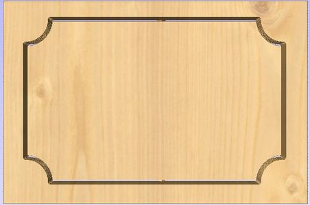

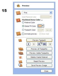

Once you click calculate, the view switches in 3D and shows the toolpath, with all the passes the tool will make to execute the job. Just click on "Preview Toolpath on the Preview Menu (15) and voila'!

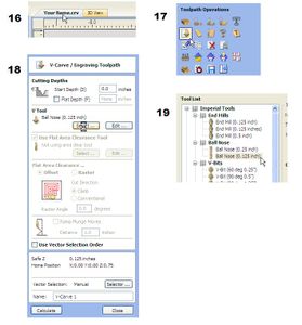

Step 6: Define the Name Toolpath
Now, switch back to 2D view, clicking on the tab at the upper left corner of the drawing area (16) and select your name and click on "Create V-Carve / Engraving Toolpath" Icon (17).
In the V-Carve / Engraving Toolpath menu (18) click "Select" to select the V-Tool, and chose Ball Nose (0.125 inch) and click OK (19).
After you understand the basic process, you can come back and experiment with different tools and see real-time what's the result look like.
Leave everything as is and click Calculate. The toolpath will show in the 3D Preview window (20).

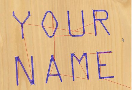

Step 7: Preview the Name Toolpath

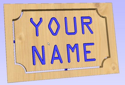

Select the color you want to have the carved path look like by choosing the "Global Fill Color" (21) and click "preview Toolpath":
If you did not anything wrong, you should see your project come to live (in a virtual way!)
Don't hesitate to experiment, you cannot damage anything now, but be careful and take the 3 classes on CNC macining and always, in doubt, ASK THE TECHSHOP STAFF, they are very helpful!
