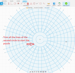

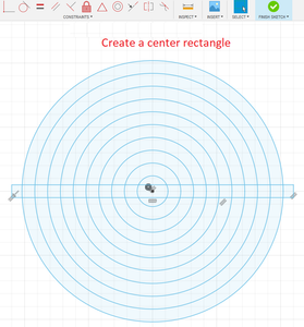

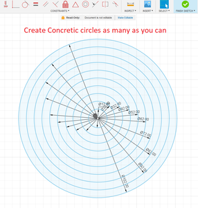

- First with Center Circle create as many concentric circles you can print on your 3D printer. I created 10 circles starting from 12mm and increasing 10mm of diameter on each one.

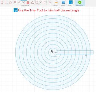

- Create a Center Rectangle to attach the center circle to the center puzzle piece (I used a 8mm thickness rectangle to start creating the links)
- Use the Trim tool to trim one half of the rectangle.
- Use Circular pattern tool to duplicate the rectangle lines into 20 more directions.
- Use the Trim tool to attach the center circle to the third circle. and Start creating maze patterns.

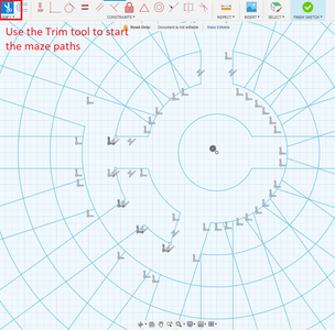

Use the trim tool to start creating maze paths. Remember this tips to create the maze paths.
- Use the lines of the rectangle to join circles.
- Join skipped circles( first circle with the third circle, fourth circle with sixth circle and so on).
- Don't be afraid of long or short maze paths.
- If you start making big maze paths we will split them in the next step.

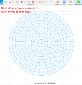

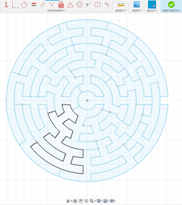

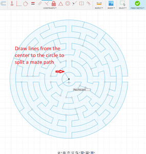

- Once you are done creating maze paths, you can see in the first image that we have big maze paths and this will result into big puzzle pieces, so we will split them using the Line tool.
- Select the Line tool and start the line by click in the center of the puzzle and then second click on the opposite circle where you want to split the maze path.

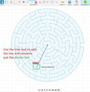

- Use the trim tool to erase the excess line.
- Repeat this for the pieces or maze paths you consider big ones. (like the 4th image)

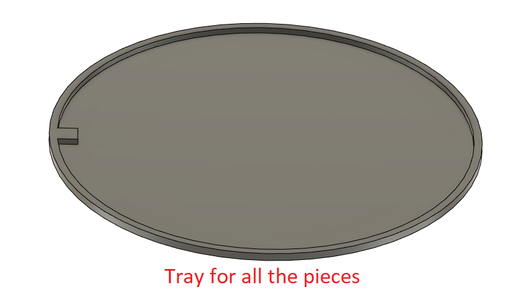

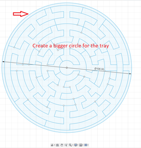

Lastly to create the tray for all the puzzle pieces, create a circle 4mm bigger than the last circle.

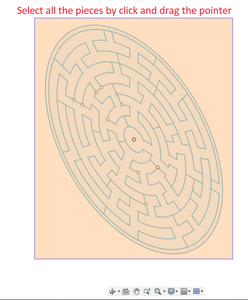

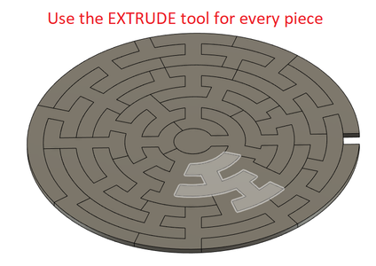

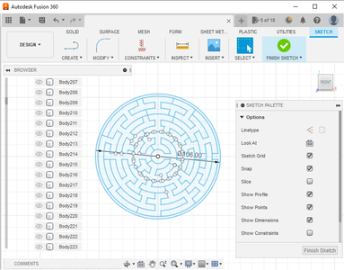

Use the extrude tool (shortcut: E) and select every piece of the puzzle and select the thickness you want.
I suggest 1.5mm to be a good thickness to avoid bending.
This might take a while as you need to select every piece, write the thickness and then select Operation "New Body".
Note: This last step is important. if you do not select "New Body" the new piece created will join to the last one.
Step 6: Creating the Tray

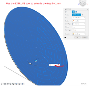

To create the tray use the extrude tool and select all the pieces and extrude, the select the thickness (I suggest 1mm).
Then create the contour, use the extrude tool and select just the inner part of the last circle you created before and extrude, select the thickness of your puzzle pieces plus the thickness of the tray (1.5mm + 1mm) and select Operation "Join" (do not forget to select join, because the default operation is CUT and we don't need to remove parts we need to add).
And you are done with the puzzle! Let's print it!

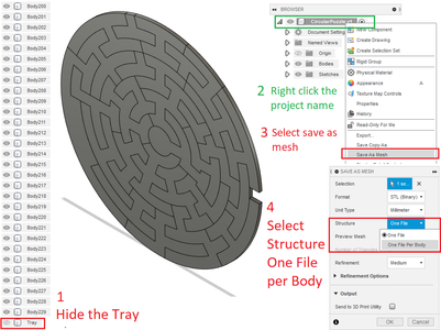

To export the puzzle:
- Click on the show/hide to hide the Tray (eye icon)
- Now right click on the name project and save as mesh
- In Structure option select "One File per Body" (this will export every piece as a file, it might take a while because they are a lot of pieces)
To export the tray:
- Unhide the tray by clicking the eye icon.
- Select all the puzzle pieces and hit V (V is the shortcut for show/hide).
- Right click on the tray and select save as mesh and click ok to save the STL file.
