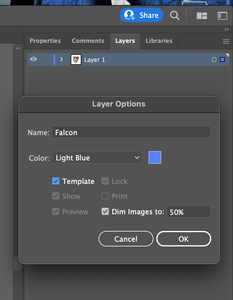

To begin creating our own Image we must make our template from the current PDF
To do this go to the layers menu on the right side of the window. Double click on Layer1(Should be the only layer). As shown from figure2 this menu will appear to make sure the template is selected and click OK.
The BG Logo should have become transparent and should be unable to edit or move.

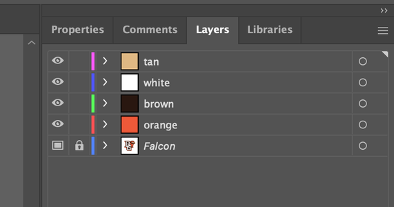

Step 3: Adding Layers
In our next step, we will be adding a layer for each color for the logo, plus one additional orange layer. (5 total)
Begin by clicking the "new layer" button in the layer menu 4 times creating your color layers. Name each layer the four colors in the order shown from the second image.
From here we must assign the color to each layer.
To start, press "m" on the keyboard. This is the rectangle tool use this to make a square on each layer.
Now press"I" on the keyboard. This is the eyedropper tool. Select a rectangle and using the eyedropper tool select the appropriate color from the logo template (Dim image).

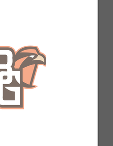

Step 4: Tracing Image
To create the vector file we will be tracing the current template to create our own unique design that we can shape and customize to our liking without losing the quality of the image. We will do this by using the "Pen" tool.
The Video provided will provide a quick tutorial on the pen tool:
Press "P" to select the pen tool. Starting with the orange layer we will trace the outline of the BG logo. The tracing process is very simple as Illustrator does most of the work for you as you click along the edges. After this select the eye icon next to the layer "orange" to hide this layer. (repeat this step for each layer)
Your results for each layer should be similar to the above images.
Add your last layer and name it "orange2" trace the orange markings on the falcon to finish your design.
