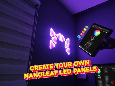

For today's project, we are going to create a NanoLeaf LED panel
The problem!
We all know that NanoLeaf LED panels are quite expensive; they cost around 12,000 PHP or 214 USD. However, you can create today's project at a very affordable price.

Next, it's time to hang these LED panels on the wall. The first thing I did was to use my meter to find the center of the wall and then mark it with a pencil. After that, I put on gloves because I am going to use a "no more nails" adhesive. Once this adhesive gets on your hands, it's somewhat difficult to remove, so I recommend wearing gloves when using it. Using the "no more nails" adhesive, I glued the panels and the case of the electronics one by one to the wall.
After completing that, I connected each end of the LED strip, and then I closed the base with its cover. This time, we need to power it up with the 12V power supply.
Step 7: WLED - Software Configuration
Now, you need to download the WLED app on your phone and open it. Click the plus button, and then select 'Discover Lights.' Once your LED is found, click the check button. Click 'Configuration,' and then choose 'LED Preferences.' The LED count should be the number of bases you have multiplied by 7. In my case, it's 56. Set the maximum current to 3000 mA. Next, under the hardware setup, change the LED color order to BRG and change the GPIO to 12, because I connected my LED to pin to the GPIO 12 of the ESP8266. Save your settings by clicking this button. You can then verify that all your settings are correct by returning to the main page and cycling through the three primary colors: red, blue, and green.

Step 9: Enjoy!
And there you have it, the project is completed! It's time to sit back and enjoy the fruits of your labor.
