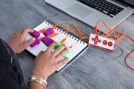

Step 1: Create Arrows, Space, and Click With Play-Doh
Using Play doh, create a d-pad with four different pieces of Play-Doh to control each arrow on your computer. Then make two balls to control space and click! (Picture 1)

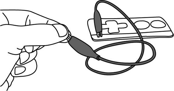

Plug an alligator clip into each Play-Doh shape. (If you don't want your alligator clips to get junky, you could clip onto a paper clip, and put the paper clip into the Play-Doh. (Picture 2)
Step 2: Plug Into Play-Doh and Makey Makey
Plug an alligator clip into each input on the front of the Makey Makey. Be sure to match the key presses on the Play-Doh. For instance, plug an alligator clip from the up arrow on the Makey Makey (Picture 1) to the Play-Doh you created as an "up arrow." Do this for all the arrow keys, space, and click.

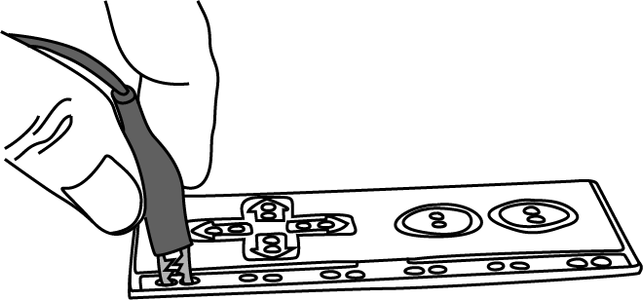

Plug an alligator clip anywhere along the EARTH strip on the bottom of the Makey Makey. (Picture 1)
Make sure when you are using your Play-Doh controller, you are always grounding yourself by holding on to this alligator clip plugged into EARTH.

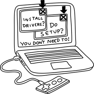

Plug the red USB cable into the Makey Makey and into your computer. All the lights on the ARROWS and around SPACE and CLICK will flash green. If you get pop up windows asking you to install drivers, you can ignore them clicking the black X in the corner. Your computer will automatically recognize Makey Makey as an external keyboard.

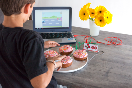

Test your controller! Remember to hold EARTH and then press on the Play-Doh to see if your controller works.
While holding EARTH, you should be able to touch the up arrow Play-Doh and your computer should think you are pressing the up arrow on the computer. Your Makey Makey will light up to show which key press the object is connected to.

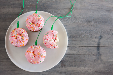

Step 5: Try Out Other Materials!
Try out other materials! Everything in the world is either conductive or an insulator. What other materials can you use to make a game controller? Can you play games with donuts? Jello? Fresh flowers?
