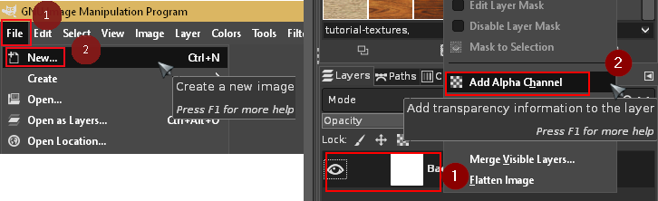

Create new image
1. File > New 2800 x 2800 pixels.
Alpha
2. Right click the layer “Background” Layer in the lower right and click “Add Alpha Channel”. Right click the layer “Background” Layer in the lower right and click “Add Alpha Channel” Delete the background by pressing the delete key. You should see a grey checkerboard.

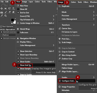

Step 3: Chapter 1 Setup: the Grid
1. View > Show Grid.
2. Image > Configure Grid.
3. Set it to 50x50 pixels.

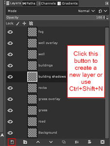

Step 4: Chapter 2 Layers: Create the Layers
1. Click to create a new layer. (you can also use Ctrl+Shift+N) We'll need the following layers:
>road
>grass
>grass overlay
>building shadows
>buildings
>well
>well overlay
>rocks
>fog

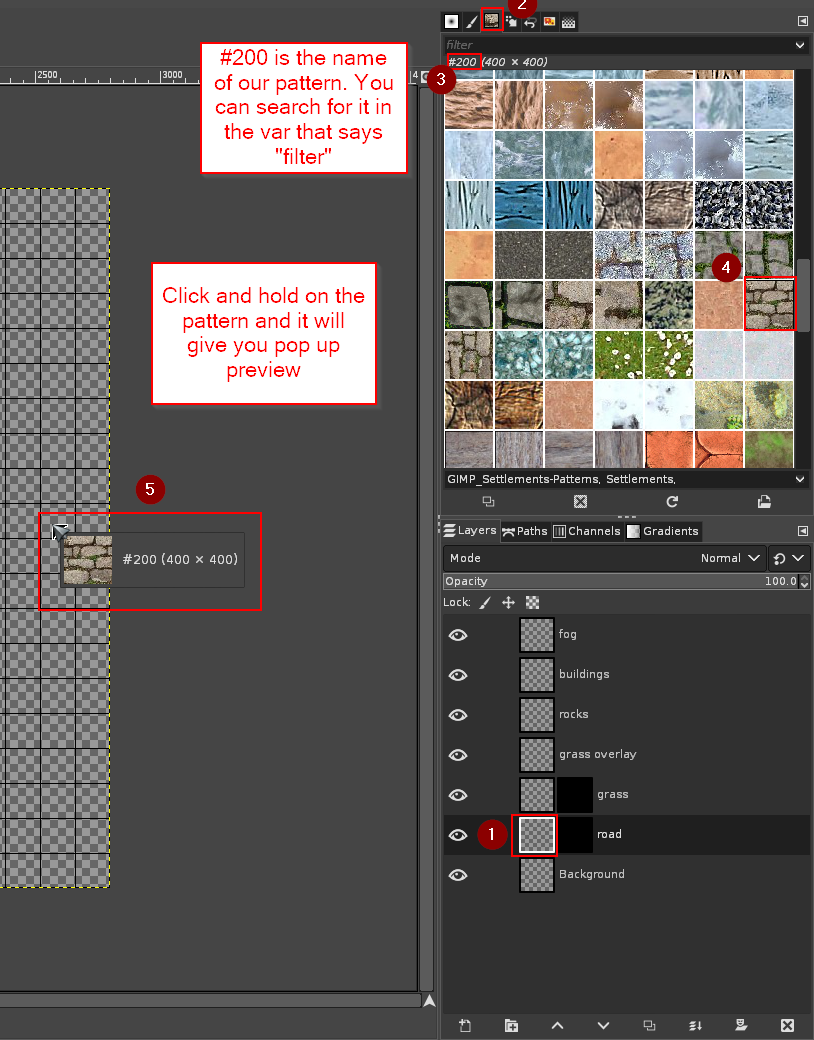

Step 6: Chapter 3: Patterns on Layers
We're going to put some texture onto the layers, but you won't see it yet because we haven't painted any white on the layer mask, the black box next to the layer. We'll need to do this for the road layer and the grass layer.
1. Click on the layer. (not the black box next to it)
2. Click on the patterns tab above. (You'll know it because there will be a lot of pictures in there)
3. Find the pattern for the layer:
>"Marble #2" for the well layer.
>"#200" pattern for the road layer.
>"#39" pattern for the grass layer.
>"#119" pattern for the background.
4. Left click and hold the pattern. (this will give you a pop up of a larger version of the pattern)
5. Drag the pattern onto the canvas.
You'll notice down on our layers that the road now looks grey/tan, the grass layer looks green, and the background layer looks brown. The canvas will look brown. Nice job! You did it!

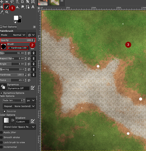

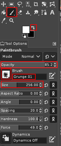

Step 7: Chapter 4: Prep the Paint Brush for Roads
We're now ready to start paining white on the road layer mask.
1. Setup your paintbush tool with the settings pictured. You can click the painbrush tool icon. (looks like a paint brush or press "P" on the keyboard)
2. Click foreground switch button near the black and white squares so the white one is in front.

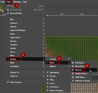

Step 10: Chapter 6 Grass Overlay: Creating Plasma Render Overlay.
1. Click on the grass overlay layer.
2. Click Filters > Render > Noise> Plasma.

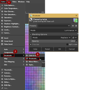

Step 12: Chapter 6 Grass Overlay: Desaturate
1. Click Color > Desaturate > Desaturate.
2. Default settings are good here. Click Okay.

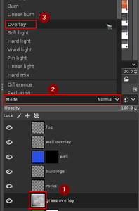

Step 13: Chapter 6 Grass Overlay: Set Layer to Overlay Mode
2. Click the drop down menu for the mode.
3. Select "Overlay".
It should now kinda look like cloud over-top the landscape.

Step 15: Chapter 7 Rocks: Paint Rocks
1. Click the paint tool and select the "hardness 100" brush.
2. Move the opacity up to 100%.
3. Paint a few different small sized rocks here and there.

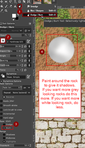

Step 16: Chapter 7 Rocks: Rock Shading
1. Click on the burn/dodge tool. (It may be hidden under the smudge tool) You can get to it quick by using shift+D.
2. Select the "Hardness 025" brush. (you may need to change the size of the brush depending on the size of rock you're working on.
3. Make sure you the "burn" bullet selected.
4. Paint around the rocks to give them shading.
You can paint more or less give give the rocks different looks.

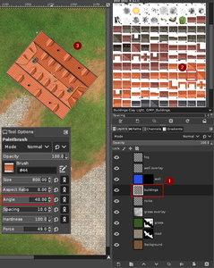

Step 17: Chapter 8 Buildings: Paint Buildings
Select the brush tool before you begin if it's not already selected.
1. Click the buildings layer.
2. Click the brushes tab in the upper right.
3. Select Building you want to paint. (remember you can click and hold to get a larger preview)
4. Click on the ground.
To rotate the buildings you can change the angle on the left side near the paintbush tool options. By default this is set at 0 degrees.

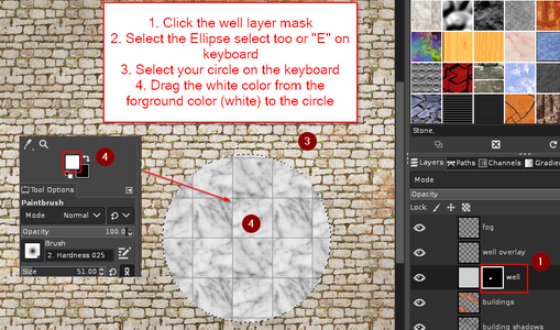

Step 19: Chapter 9 the Well: Paint the Layer Mask
1. Click the layer mask for the well layer. (the black box)
2. Click the Ellipse selection tool. (or "E" on the keyboard )
3. Select a circle in the center of town.
You can get a perfect circle by holding Ctrl+Shift after you've clicked to start the circle.
Make sure to leave enough room for a border inside your selection.
4. Drag the white color from the colors on the left to the circle. This will expose our marble pattern.

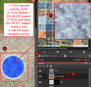

Step 20: Chapter 9 the Well: Create the Well Border
1. Click the well overlay layer.
2. Click Select > Shrink. Shrink by 20 pixels.
3. Drag the "#181" pattern to the circle.
4. Change the layer mode to overlay.
5. De-select the circle by clicking on Select > None or Ctrl+Shift+A.

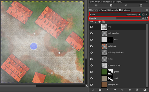

Step 24: Chapter 10 Fog: Change Layer Mode
1. Click the Fog layer and change the mode to "Lighten only".
2. Change the opacity to a level that looks more like fog than clouds.
