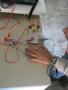

  1. Draw and cut out of cardboard the the shape of your controller game. Use the material you like to decorate it. (Image 1)
  2. Create a d-pad with four crowns filled with Play-Doh to control each arrow key on the keyboard of your computer. Insert a metal spoon in place of the space bar simulate the mouse left click trough a pop -top (Image 2)

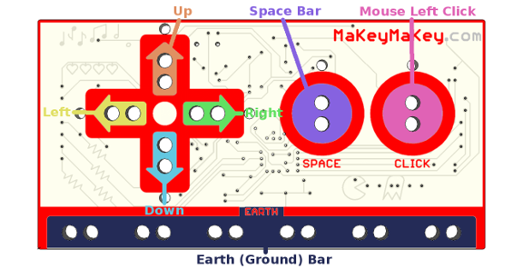

  1. Connect each crocodile clip to the Play-Doh shapes or to the metal parts (Image 1)
  2. Connect each crocodile clip (the arrow keys, the space bar and the mouse left click) to its input on the front of the Makey Makey. Be sure to match them properly. For example, connect the crocodile clip you created as an "UP arrow key" on the cardboard shape with te "UP arroy key" on Makey Makey (Image 2).

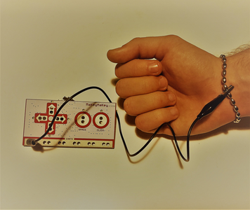

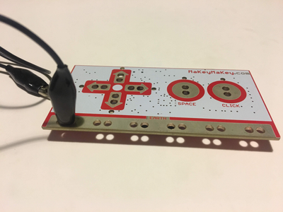

  1. Connect a crocodile clip anywhere along the EARTH strip at the bottom of the Makey Makey (Image 1)
  2. There are many ways to ground, the easiest is to pinch a living being. Actually, just touching the metal part of the crocodile clip you can close the circuit. (Image 2, 3)

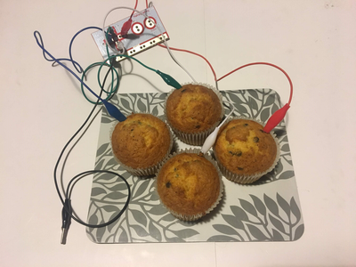

And now try using other materials for your controller game: marshmallows, miffin and some more.
