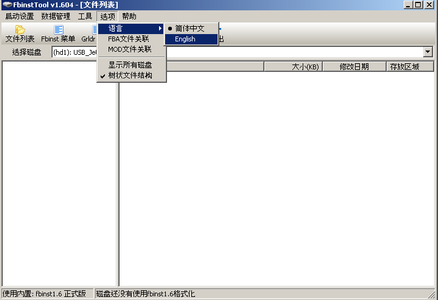

Execute FbinstTool.exe.You will get a User Account Control Dialog Box.Click Yes.
Change the language of the user interface to English
