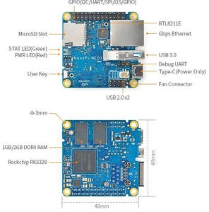

Jamstud.io is a free software that allows you to play music online with minimal or no latency. As Jamstud.io developer but also regular user, I wanted to simplify my setup to remove the need for a dedicated PC or Mac. To achieve this, I decided to use a Bheringer U-Phoria UMC22 and integrate a Nano PI NEO3 directly in it. This way, I could have a compact, simple and dedicated device that allows me to play music online.

  4. Soldering the the lower row of the switch to the wires ending with a female pin connector and connect them to the USB pins of the Nano pi Neo 3 USB 2 pin
