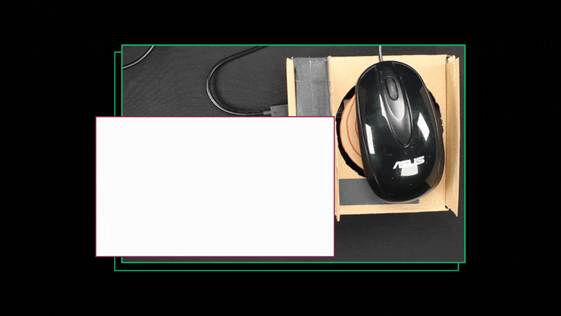

Introduction: Create a Lazy Susan Using a Motor and Raspberry Pi
Welcome to the robotic world of culinary comfort and supreme convenience! Are you sick of straining your arms to transfer plates around the dinner table? Are you tired of being taken away from your delicious meal to pass the rolls? Have you ever dreamed of a spinning device to do this chore?
By the end of this tutorial, you will have learned how to wire a motor and motor driver to a Raspberry Pi, install viam-server on your Raspberry Pi, and how to configure your robot in the Viam app to create your own Lazy Susan for your dinner table!
You will also learn to take your creation a step further and fine-tune the controls of your Lazy Susan using the Python motor API methods.
