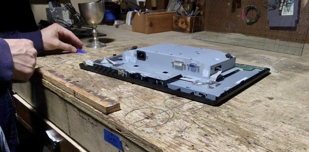

Step 1: Taking the Outer Case Off

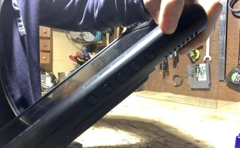

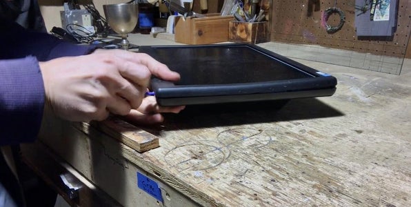

Using a screw driving set/pry bar, take the housing off. Depending on your of screen, this may be easy or really difficult since some manufacturers use security screws or hard to reach plastic clips.

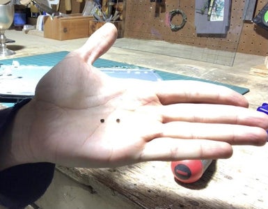

I used a cup to keep all of my screws safe from falling off the work bench, especially since some are so tiny. A magnetic pan would also work and probably be more appropriate if you can get your hands on one.

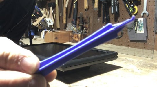

I used a plastic pry bar (I cannot remember where I procured this tool in pic 1) to work my way around the case to separate the plastic pieces. A lay down mat or cloth would probably be a good idea, too. This way you don't scratch your monitor screen. Be extremely careful if you have to pry the plastic tabs apart because you don't want to risk breaking the monitor.

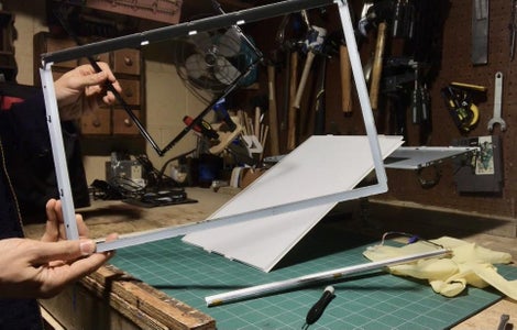

My screen has several shiny layers which are the key components for the diffusion of light. I used gloves when handling these so I would not leave any fingerprints.
NOTE: In hindsight, my shop wasn't the best choice for disassembly since "floaties" may attract themselves on the layers.
I am not sure what all the layers do besides filter, polarization, and diffusion but you'll likely want to note the orientation and queue of them. If your light looks odd when you're done, you may have messed up the order. I usually will take a video of any disassembly process so that I have something to fall back on when (not IF) I forget.

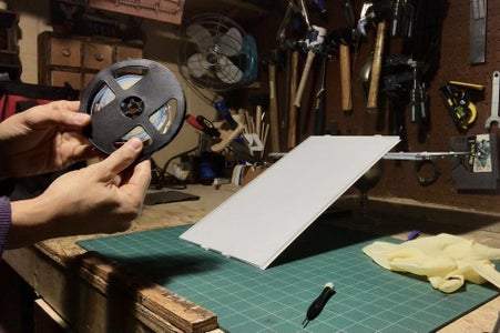

I removed the old light source and get the screen ready to accept the LED strip. They look like teeny tiny fluorescent lights like you see in an office. I am not sure if they can be repurposed but let me know in the comments if you found a good use for these, and also, how to test them!
Step 4: Installing the LEDs
I didn't want my LED strip to be one continuous loop around the outside of the housing so I worked it around the top and bottom, similar to where the original light tracks were fitted. The LED strip comes with joints that you can cut and re-solder as you see fit. This may or may not be necessary depending on your monitor or where exactly you want your LEDs to go. My soldering skill needed some more experience points and this project was good for my own personal skill building. Some LED strips come with a sticky backing which both helped and got in the way of installation. At times I laid a bead of hot glue down to keep my LED/wires from moving out of position so that I could proceed.

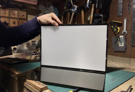

Now that things are reassembled, I flipped the switch on and worked on reducing shadows (Don't pay attention to the massive shading in my cover photo. That was me being silly :D
You can see from pic 1 to 2 that the lighting really helps reduce unwanted shadows.
This mainly helps me make videos and taking better photos. In particular, closeup shots for re-selling items on interweb market sites.
